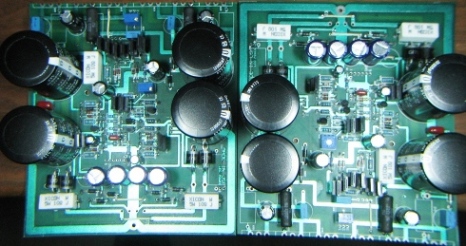

Perfect. This is a very cool output stage and I'm having a lot of fun with it. It's very versatile as people have suggested. I'll continue to post experimental results in the 100W Krill builder's thread.
I've started experimenting a little with different types of bias control transistors. I am using a Borbely-designed voltage gain stage with the Krill o/p stage. The output stage is identical to that in Steve's post #1460 (above) but using 4 pairs of output transistors.
I just substituted MJE340/MJE350 for the two bias control transistors (Q8 /Q11). I ran the amp for 30 minutes at 1 kHz, 10W continuous into an 8 ohm load. All worked fine with no problems. The voltage rails for the Krill o/p stage were +/- 56VDC.
I've got a few more pairs of different transistors to try there. I'm curious as to what will work before building the listening prototypes. I have 2SA1111/2SC2591, 2SA1209/2SC2911, and MJE15032/MJE15033 pairs to try out. I haven't checked out the SOA, gain, etc. on these yet but will.
Thanks Phil for these experiments - I for one am following you avidly as I'm sure are lots of future Krill builders.
Thanks jkeny. I've settled on the 2SA1943/2SC5220 pairs for the drivers and outputs but curious about what works for Q7/Q10 and Q8/Q11. Although I don't have the ability to measure distortion yet, the circuit works just as Steve has described in terms of bias and offset adjustments. I'm looking forward to finishing both amps for listening.
