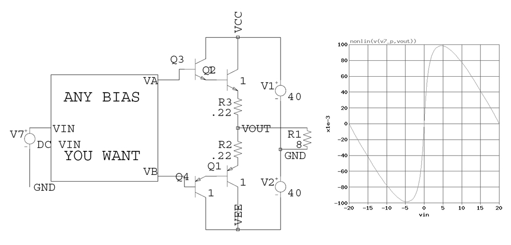

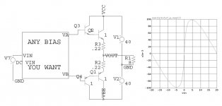

>Third and fourth paragraph: The AC voltage between the emitters of the bias pair remains constant (well very close). I thought I had answered your last question. I may have done that in a thread started on another DIY site. There is not an AC voltage drop across that cap. If you look at either side of the cap, you will see an exact replica of the input signal throughout the entire cycle. If you look at both sides of the cap differentially, there is no signal .<
Let's forget 20kHz and look at DC or low frequencies, the cap would be between my VA and VB in attached schematic (please keep in mind above bolded text). The plot is the deviation from a straight line of the input vs output, about .1V peak on a 20V peak signal. This is the simple logarithmic relationship between Vbe and Ic for any transistor.

That is clear. "Any bias you want"

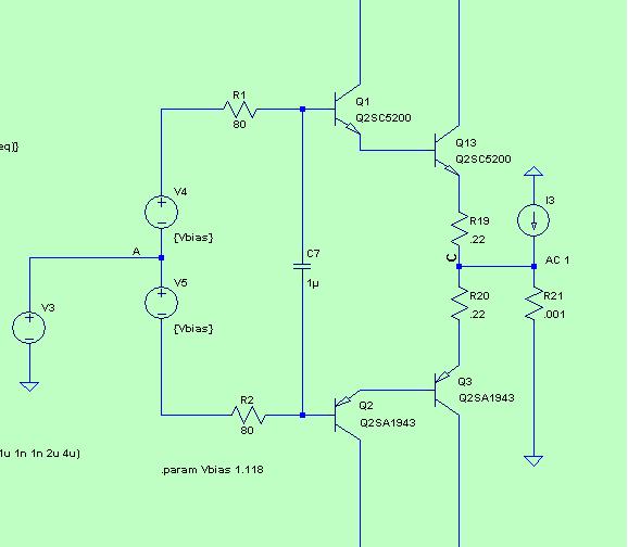

I have been analyzing the output resistance of the bias circuit. It is highly dependent on transistor choice (the specific turn-on region Ic vs Vce curves) but looks like it will typically range from 20 ohms to 120 ohms or so. My ZTX458 model gives about 80 ohms. It will depend upon the current source values and the specific output transistor types too.
I mention this because series resistance is important to the dynamic linearity of the darlingtons. So don't overlook these when you consider alternative bias schemes. The 1uF cap should be on the driver side of the series resistors.

Has anyone else tried simulating with those 2SC5200 and 2SA1943 models?
I've had a go (used them for both drivers and outputs). The models don't seem to be especially complementary for some reason. I'm getting about 500ppm at 10kHz, 30Vpk, 8ohms. By cheating a lot (conjuring up perfect complements for all transistors) I managed to get it to 130ppm.
