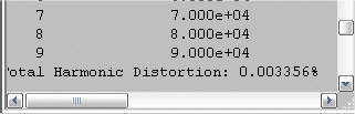

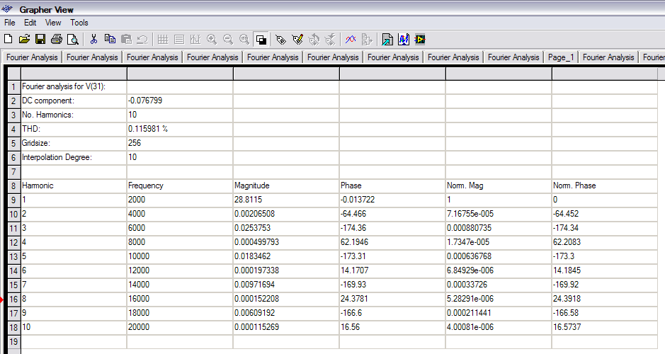

OK.. we have to put this to rest..
I got the same .12% on the krillOPS.asc using a virtual source.
that seems to be the problem (as I told GK) virtual zero
impedance does not give a fair/objective representation.
With the DC blocking cap put into Krill1.asc(sorry again) I got .052% at 20k.
I then disconnected the OPS and used andy's gen
on just the krill input stage , again .05%
Then (I didnt include it) I built my holman input stage onto
the krillops.asc, thats where I got the .003XX from
my input stage does not seem to like the local NFB loop
coming from it's vas (but only when hooked to the krill OPS )😕
so I "wrapped" the NFB around the whole
thing (just like my triple EF) and did a strait A/B
came out to be .003% total (my holman stage .001/Krill OPS .002)
same as krill1.asc.
I only included krill ops.asc for some to "add thier own" input.
