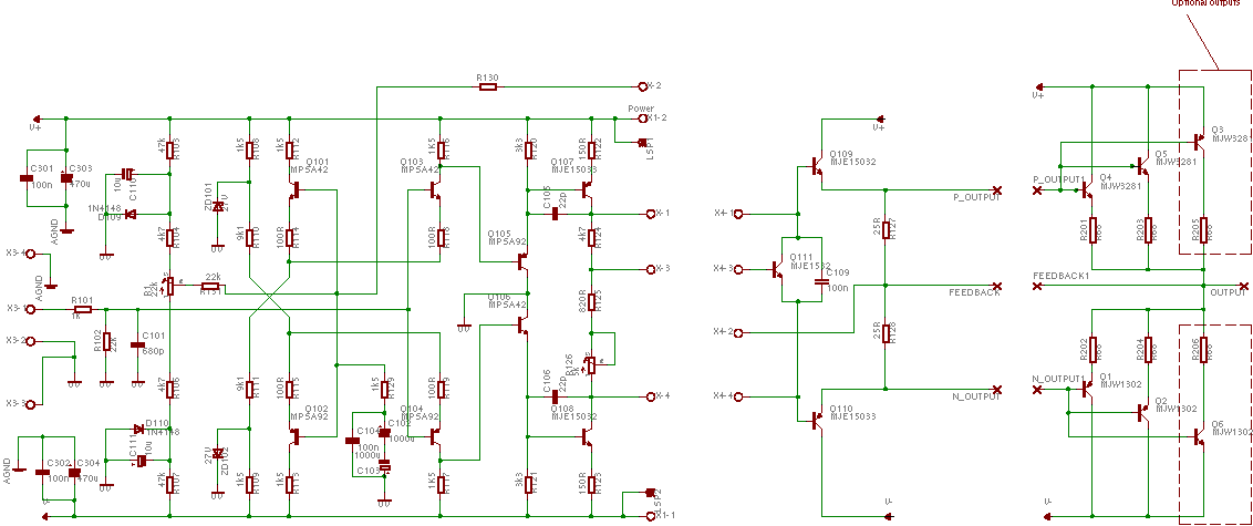

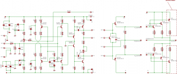

Sorry guys, 'cos of the thump, I couldn't help tweaking some more.
Well guessed Mark, I did have larger caps, but in C102/103. I swapped them out for the spec-ced 1000uF and the thump disapeared. But the amp didn't sound as sweet. So, if you're using a relay type turn on delay, then definately increase their value. I was using 1800uF Rubycon MBZs, and they were pretty good, however the ones I replaced them with were only "cooking" electros. I feel this is an area worth experimenting with.
I also tried the 2SC2240and 2SA970, and to be honest, I saw or heard no difference, so I will stick with the layout using MPSA42/92 throughout.
The amp is now running at 42V rails, 500mV bias and the only alteration required was increasing R122/3 to 150 Ohm, the existing 101 Ohm were running just a little hot for my liking.
Measured gain is about 22, and all seems stable with C105/6 at 22pF. These caps might possibly be reduced a little more, but this seems a good place to start.
A friend of me, who owns a KSA100, changed the two series cap's with one 470µF BG-N cap and he was very satisfied with that.

And the parts list:
Partlist
Exported from KSAtest.sch at 5/03/2005 00:19:13
EAGLE Version 4.13r1 Copyright (c) 1988-2004 CadSoft
Part Value
C101 680p
C102 1000u
C103 1000u
C104 100n
C105 22p
C106 22p
C109 100n
C110 10u
C111 10u
C301 100n
C302 100n
C303 470u
C304 470u
D109 1N4148
D110 1N4148
Q1 MJW1302
Q2 MJW1302
Q3 MJW3281
Q4 MJW3281
Q5 MJW3281
Q6 MJW1302
Q101 MPSA42
Q102 MPSA92
Q103 MPSA42
Q104 MPSA92
Q105 MPSA92
Q106 MPSA42
Q107 MJE15033
Q108 MJE15032
Q109 MJE15032
Q110 MJE15033
Q111 MJE15302
R1 22k
R101 1k
R102 22k
R103 47k
R104 4k7
R106 4k7
R107 47k
R108 1k5
R109 1k5
R110 9k1
R111 9k1
R112 1k5
R113 1k5
R114 100R
R115 100R
R116 1K5
R117 1K5
R118 100R
R119 100R
R120 3k3
R121 3k3
R122 150R
R123 150R
R124 4k7
R125 820R
R126 5k
R127 25R
R128 25R
R129 1k5
R130 22k
R131 22k
R201 R68
R202 R68
R203 R68
R204 R68
R205 R68
R206 R68
ZD101 27V
ZD102 27V
