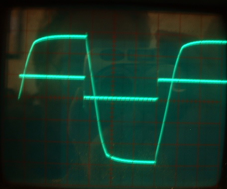

Hey!! There's a reflection of some goofy guy holding a camera!!pinkmouse said:1KHz square wave. Top trace output, bottom trace source, (x10). 😀😀😀

Right, before I go out...
Emitter resistors on Q107/8 increased to 330R as my rails were a bit high, and they were running very hot, but I'll swap back later.
Input -10KHz square wave, 0.75V P2P.
Output -12V P2P
First pic - 330pF on Q107/108. Hmmm. If that's what you put in, rip 'em out...
Output -12V P2P

With 33pf i don't remember my scope readout looking like that!!!!
Hmmmm....... I don't have a signal generator (nor does my scope) but the input was the same as the output just more swing...
I never saw it looking that bad!
This type of information should be put in the WIKI so that subsequent builders can use the info gained in your testing, the schematic says 330 pF. I know you probably haven't had time yet, but remember its a pain to read through all these posts to tweak the component values. Just trying to encourage wiki building. wiki
I do have signal generator but figured many of us DIYers don't. For this reason I've put some test tones on my web site for dowloading by anyone. You can burn them to cd or tape then presto! you've got a signal generator. Click the www link below.
To Al : Value of C 105/106 must be as possible low, 'cos this compensation reduce OLG at high frequency, which lead to rising of distortion. Try to get there lowest value, by which amp will be still stable.

Pavel - I think I will try using the old twisted insulated wire method to see if I can get something of around 5pF to try.
Aaron - that was a 10KHz square wave, a difficult test for just about any amp. Normal sine waves or music won't show anywhere near that kind of distortion. But if you get chance to put a scope on yours, I would be interested to see your results.
Lgreen - I'll have a go at adding some stuff to the wiki tomorrow. Good idea about the test tones, but what does a 10KHz square wave look like from a cd?
All - So far I have been using MPSA42/92 throughout, but I might give the original spec-ced 2SC2240 and 2SA970 a go and see how they work. If they perform better I will have to tweek the pcb as the pinout is different, so it would be handy to know now! 🙂

The 10 KHz square wave is so high in freq, that recording to 44.1 KHz sampling rate turns out not to come out very good at all. You are limited by sampling rate and there is a lot of ringing. For example, I've got a 1KHz square wave for download. Here is a link to the 1KHz square wave data. As you see, even at 1KHz you have a lot of ringing.
