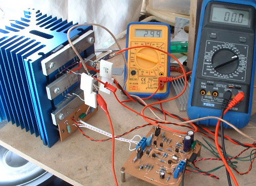

Ok, we have a Final Version!
It's been sitting at 300mV bias for an hour, DC offset is totally steady at 0mV, and the square wave looks a lot better. I have swapped the outputs to MJ1302/3281 because they sound and measure a lot better.
As for the sound - Wow... It's solid, clear and with loads of definition. This is a great amp!
I'll get on with sorting out the PCBs, schematics and BOM over the next few days so Mark can start moving ahead with the group buy.

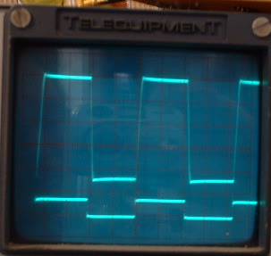

It's actually just following the ringing on my frequency generator, I'll post a pic after I've had my dinner. 😉

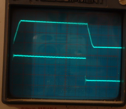

pinkmouse said:Ok, have a look at the ringing on my signal generator, the bottom trace...
I might have to take it apart and have a look, it never used to be that bad.
Yeah, with that much ringing I though someone would have picked up the phone by now! 🙂 🙂

Al, your signal generator have too short rise time. If you can, try get at output HF filter with band wide cca 1 MHz, you get probably much more stabil signal. Is not neccessary measure amp with square signal, which have nsec rise time 😉 . And Krell : have you try get there lower compensation ?
