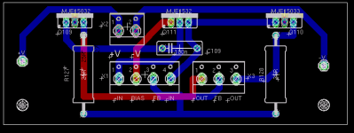

Quick question:
As I'm now using/recommending TO247 packaged outputs is there a demand for a PCB for them? It shouldn't take long to knock up if required.
edit: for testing I was using Brian's Mini A pcb, as it was slightly less bulky than my big one, so with the bigger caps it should be fine without a redesign.

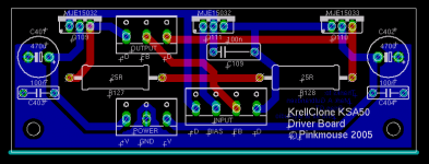

Al, make all terminals screwed, not only ones screwed while others soldered 😉 . Give at driver board bypass caps too, it is critical place for stability.

pinkmouse said:Last chance to comment.
Do we want component names or values on the silkscreen? It's a bit too crowded to have both...
I never have values printed in the silkscreen. It's easier to just have the component names, and then make a BOM.
If you have the values on the board, it's going to be confusing when the BOM changes.
\Jens
GeWa said:Al, what are the dimensions of the output board?
40mm x 90mm, half that of the main board
JensRasmussen said:If you have the values on the board, it's going to be confusing when the BOM changes.
Good point, thanks.
Al, driver board look nice now 😉 . Still remake input board for screwed terminals and all will be OK. 😎
