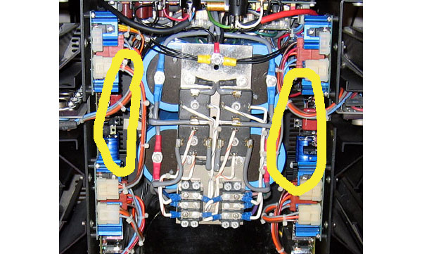

Any idea what the bigger black heatsinks, (see annotated pic below), under the driver boards are for?
Those are just ventilation louvers in the bottom sheet of the chassis. It is some what deceiving though.

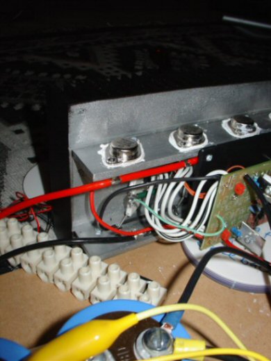

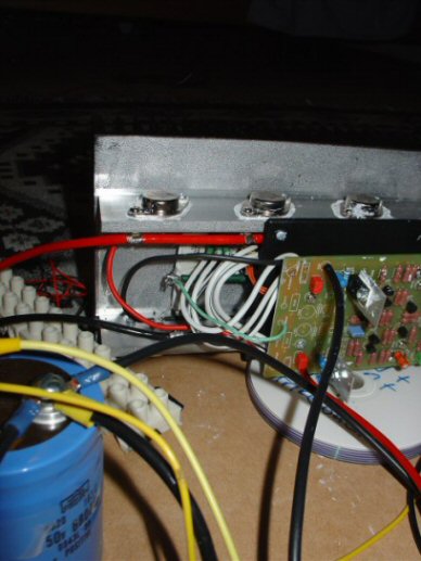

Well i did some "modding" and managed to make the drivers and bias fit between a set of emitter resistors... It was a tight fit, hard to drill and very fiddly! (Took about 4 hours for the whole move! Not sure why, or where the time went!)....
Now the drivers sit at about 35 deg (22 ambient)... So they are stone cold... heatsink (whole thing) sits at about 36 and the hottest output sits at approx 41deg (at 22 ambient)... The predrivers sit at 36deg with the alloy tabs still on them....
Bias has gone up 8mv after 30mins of running.... So it's stable... very!
I'm gonna keep and eye on it for a few hours and see how it goes... Pics follow
Well done Aaron, that looks pretty neat. 😎

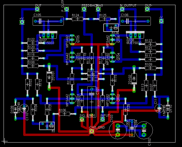

Well, as promised here is a new layout with what will be a separate driver board, not finalised yet, but you should get the idea. Tried to keep signal paths as short as possible, and avoid any inductive loops, etc.
Great job on the board!! I wish it coulda been that way from day one but I guess improvements always come over time. If you do a group buy you can very definately count me in for some of those.
One thought... Would it be possible to eliminate the radial mount caps in favor of axial mount? This would keep the finished profile of the board very shallow. The only real protruding thing on it are the two 1000 mfd caps. Also turning R-126, the bias pot 90 degrees counter clockwise and placing it under R125 and to the left of Q-106 would leave that area a bit less cluttered. There is a square open area below R125 that it would neatly fit into.
