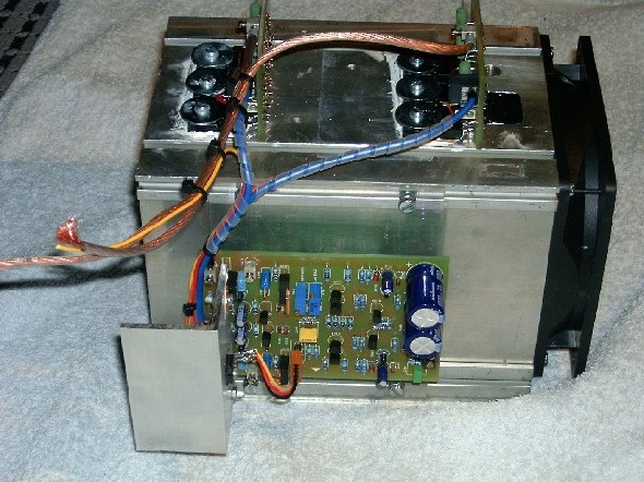

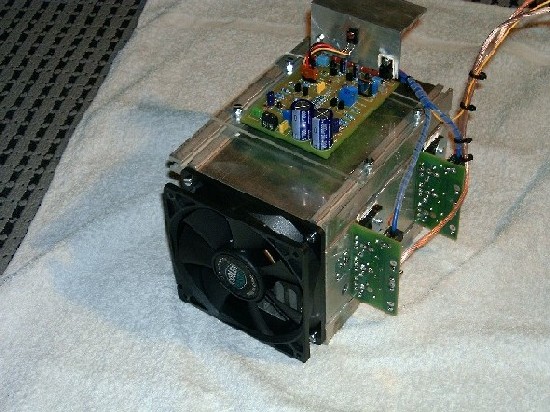

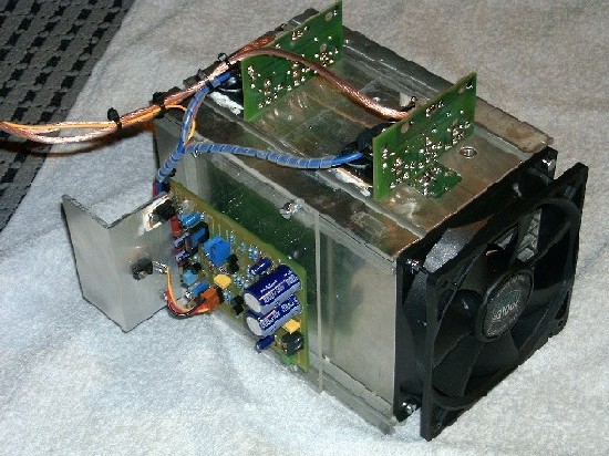

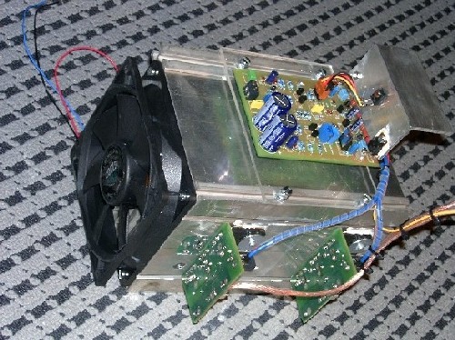

Looking good Wim! That sink should be quite efficient. You may find that your drivers run a tad too hot though. I was uncomfortable with mine and moved them over to the main acerage(sink).

Its ready to fire up, but i did not yet. next week i think.
When the driver get too hot, i will expand the little alu heatsink on the mainboard. Its easy to make the surface a lot bigger.
