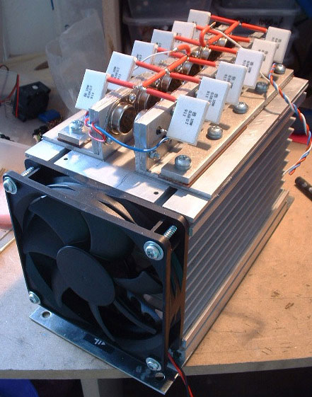

Output stage finished. Now to finalise the pcb...

Wim: No, not yet, I'm designing my own PCBs, and they are yet to be finalised. I am also still waiting on my big PSU caps. As for the heatsink temperature, I'm going to knock up a variable speed controller for the fan, then crank the bias as high as I can get it without too much noise.
Hey Pink,
The last time I made a P2P rig that nice looking, the amp produced wonderful sound for 3 mins then blew ... it's been 2 years, I have not had the heart to rip it open and trouble shoot. :bawling:
I wish you better luck, nice work... I see Stuart has been very busy with sharing his cache of 0.68's 😉

K: Just stick some more outputs on it!
Thanks Stuart, I just hope it all works, or it will be a sculpture in mixed media on my mantlepiece!

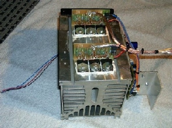

My first fotos (bad quality)
1 chanel, mounted on a windtunnel; PSU for 1 chanel is a toroid 2x30V 800 VA and a cap per rail from 47000 uF 63V. Toroid with softstarter, without it my fuses get out. (not on a foto yet).
With this PSU 1 get a nice 2x41V.
