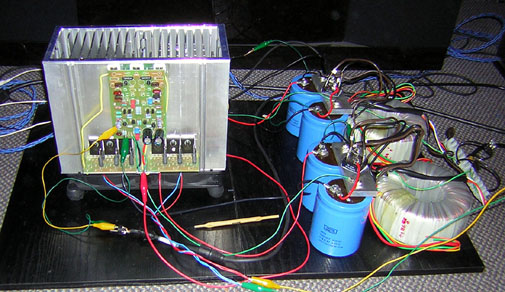

I finally had time tonight to work the 2nd supply in and get it running true dual mono. The difference is astounding! Really allows the dynamics in the music to jump out and grab you...... or slap you if thats the case. This ain't no 50 watt amp, thats for sure! Also realized by this addition was much improved low end distortion, now pinpoint, almost 3D soundstaging which is the best I've heard in my system from any amp. Both toroids are 769 VA surplus units I bought several years ago, and the caps are 58,000 50 volt jobs. This is all pretty close to what the original KSA-50 had except that these trannys are quite a bit larger in VA rating. I can really see whay so many reviewers still use these amps.......
