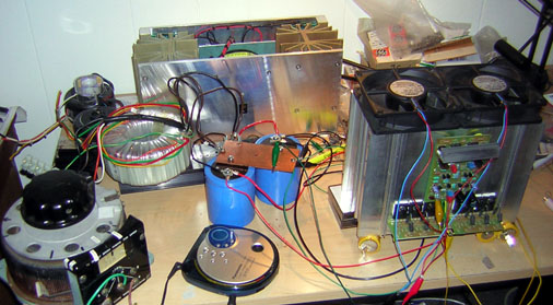

I will be using metals cans in a wind-tunnel. Stuart is helping me with some circuit mods, I will be doing a high biased class-AB with higher power. Rails about 82vdc. plan to use 4 pairs of mj21195/96. All OP wiring will be point to point on the heatsink. the input VAS will be on the group boards. Thats the plan so far...

"Mark,
nice photo of your setup. Well done.
The fans appear to be blowing (definately better than sucking).
Can you invert the sink so that natural convection augments the fan pressure?
The heatsink will have slightly higher efficiency if you can mount the output transistors about 40% of length up from the bottom. Some sources say middle of length but I disagree. Any comments?"
Absolutely! Tha fans will end up on the bottom of the sinks. Today, time permitting I will fasten the two sinks together at the sides and mount the fans to the bottom..... a bot more fabrication to do there.....
Didn't give any thought to the actual position of the devices on the sinks. A bit taller standoffs under the board would allow me to move them up towards the center of the sink. Efficiency is everything with this amp.... Thanks for the tip!
Mark

Aaron, I actually do mean +/-82vdc :D . I have some Toroids lying around for this. Yes as it is it would kill the amp but we would need to reduce the bias, change component values and increase OP devices. Stuart is da man doing the calcs for me. I have 6 boards, so 2 will be clones, the rest of the 4 will be some kind of KSA-100 or KSA-350 (class-A or AB have not decided yet) .... depends......:devilr:
Am listening to mine tonight for the first time in stereo... Just on my NS-10's for now but the NS-10's sound better than they ever have. Output device temp is about 57.5 deg c. with the fans running on about 5 volts and the draft sucking up through the fans..... a temporary arrangement. I am pretty comfortable with that temperature though. INitial impressions are that it soulds alot mike my KSA-80 did in the mids and top end.

"Are these the 4312 or the 4312L, Mark ?
The regular 4312 does 48dB at 2800 rpm."
Jacco Vermeulen,
These are the M version. At 4.5 volts you have to have your ear right next to them to hear any noise. This might equate to a noise level in the mid 20's....? Keep in mind that 2800 rpm is at 12 volts. I've found im my work that three bladed fans are ALWAYS alot quieter than fans with more blades, such as 5 or 6. Those type fans wuill actually whine somewhat at normal operating speeds. These 4312 M's have been laying around since my power follower days about 5 years ago.....
Mark

Mark,
the only square 3-blade Papst models i know of are the:
4550 - 4580 - 4850
The 4850 is the least noisy of the three, 30dBA at 1750 rpm.
A 5-blade Papst 4890 does 28 dBA at 1450.
Seems to me that RPM has a much greater influence on sound level than the number of blades.
My thought would be that a 5-blade vent at a lower speed produces the same airvolume as a 3-blade model at higher rpm, but with lower noise level.
The material used seems a factor too, the 4312 uses a GRP hausing and rotor, other Papst models are fully made in alloy.
I heard a KSA50 once, afraid i listened to the KMA400 too.
(big boy, measures 23" wide by 28" deep)
I found the KSA50 very noisy, anyone know what kind of vent was used in the little Krill ?
On the picture you posted is a second duct in the background.
It looks as that you placed inductors inside the tunnel.
Intentionally ?
That looked like a great idea, integrating powersupply inductors inside a vented heatsink.
Jacco.
