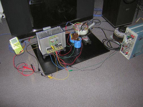

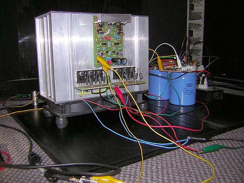

Up and stable!
Ok,
I got mine up and running...
5 pairs of output transistors... TO-3 variety (as mentioned above!)
Now running 40vdc rails (loaded down a fair bit... i MAY be going beyond the toroids ability - how do i know when it's run out of steam????)
Few questions...
I had 41vdc rails with 150ma bias ("highest" out of the 10 chips... by about 10ma) heatsink was sitting at 58deg after 1 hour...
What sort of output would i have got from that (class A - i'm running into 4 ohms)?? 🙂
Next: I'm now running 2 12cm fans @ 9v and they are going ok, reasonably quiet, silent about 1m away...
Now running 250ma bias (varies a little but no more than 10ma difference between all the outputs) with 40vdc rails - what class A would i expect @ 4 ohm? The heatsinks are sitting at 39deg also the outputs are also at 41deg approx (all the same)...
I will be running more bias than this, but if i go higher with the adjustment the rail voltage drops pretty fast, so i think i have hit the limit for my toroid... 🙁
How much heat should i be dissapating at the moment? I'm guessing (going on calcs) about 150w??? I'm using 0.68ohm emitter resistors... Are those calcs about right?
Last question - on my board the P channel pre-driver gets hot (about 51deg) and the n channel gets about 45deg - is there a reason for that? the drivers is hard to tell as they are on the same sink, but appear to have about 3deg difference... The outputs however have the same (exact) temp across every output...
Should i be worried?

Aaron,
Email me with
1) Your voltage drop on the 0.68 resistor in mV
2) Number of pairs of OP's (5 right?)
3) loaded rails are at?
4) Speaker load.
And I will calc your numbers for ya.
thanks,
Arif

Mark, I just wanted to make sure I do not overload the thread with data irrelevant to others, if you think it will benefit people here it is: 🙂
Aaron's first scenario:
Class-A output Calculation: Krell KSA-50 Mk. II
Inputs
Number of output devices: 5 Pairs
Voltage rails (per rail): 41 volts
Emitter resistance (per device): 0.68 ohms
Bias voltage per Emmiter resistor: 100 mv
Idle bias per device 147.1 mA
Speaker ohms 8 ohms
Results
Idle bias per device: 0.147 Amps
Total Amplifier bias (per rail)** 0.74 Amps
Total Amplifier bias (both rails) 1.47 Amps
Total Dissipation (per channel) 60.3 Watts
Dissipation per device pair at idle 6.0 watts
Class-A output: Peak 17.3 Watts peak
Class-A output: RMS 8.7 Watts RMS
Efficiency 14.35 %
Aaron's second scenario:
Inputs
Voltage rails (per rail): 40 volts
Bias voltage per Emmiter resistor: 170 mv
Idle bias per device 250.0 mA
Speaker ohms 8 ohms
Results
Idle bias per device: 0.250 Amps
Total Amplifier bias (per rail)** 1.25 Amps
Total Amplifier bias (both rails) 2.50 Amps
Total Dissipation (per channel) 100.0 Watts
Dissipation per device pair at idle 10.0 watts
Class-A output: Peak 50.0 Watts peak
Class-A output: RMS 25.0 Watts RMS
Efficiency 25.00 %
4 ohm class A output is exactly half of 8 ohm. These calcs represent 8 ohms. Below are the same with 4 ohm loads:
Inputs
Speaker ohms 4 ohms
Results
Class-A output: Peak 25.0 Watts peak
