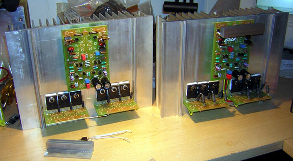

Here's where I'm at so far. The module on the right has been run for anout 10 hours... 36 volt rails at 1.8 amps bias level/400 mv resistor drop as in K-Alps calcs. This was with a smallish fan runing slowly and the sink temp was a mild 48 deg c. which is very reaonsble. That channel sounds very good. Offset can be adjusted to 0 mv and seems to hover there or right around just a few mv max over time. I think that I will turn both these sinks face to face and make a wind tunnel out of them for best efficiency. 2- 3" fans running slowly to keep the sink temp reasonable. The main sink seems to pretty much track what the driver stage is doing as far as temperature. I still have my 330 pf caps in there but plan on lowering them when time permits for testing.

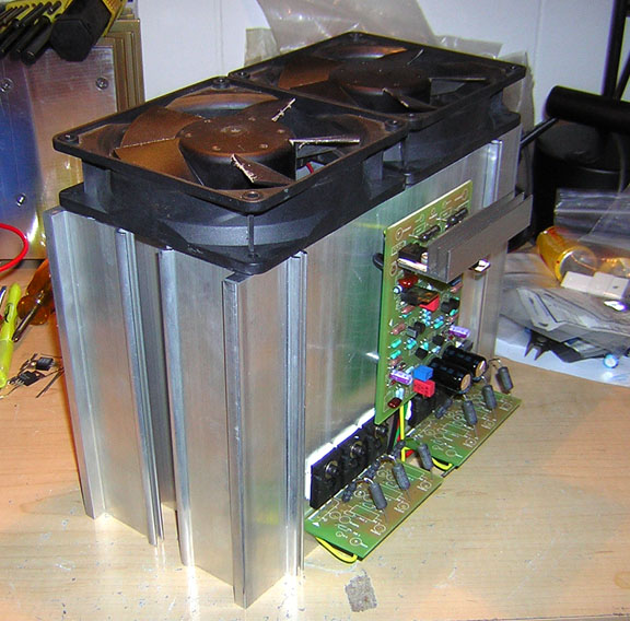

Here's the heatsink I just bought from Ebay, I just hope that with a fan or two and a bit more ducting it will work ok.

heatsinks
Wim wrote:
€ 50,00 for 1 meter is very cheap!
I think when you bye one meter, you can make two tunnels of 12,5 cm lenght, because for 1 tunnel you need 4 parts...
Am I wrong?
Loek
Am I wrong?
Loek
To nutttr : After cca 300 W loading ( power consumption of one channel ) rails voltage fall at 5 - 8 % lower than with no loaded value, so you will have there bellow 40 V. " Don't worry, be happy ... " 😎 .
To Loek
Sorry, a bit to quick with the submit button.
You can make two 125mm high tunnels out of 1m of extruded heatsink. It wont be exactly 125mm because you have to take in addition the width of the seven cuts you have to make.
