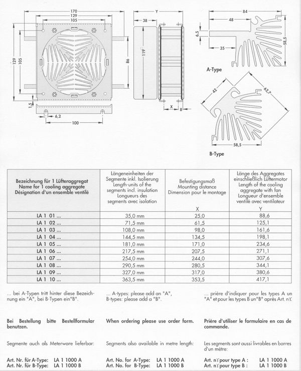

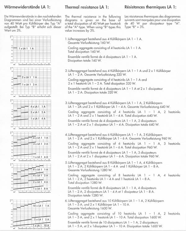

I am talking about Fischer SK 109 heatsinks with alu plates to make a windtunnel (they are optional), 18 cm high, and sorry, i see that it is 0,3 K/W without fans.

Yes GeWa, they look great and very "Krelly", but they are not very high i see in the datasheet, and i did not see how much K/W they are (eith and witout fan). Do you know this ratings?

The heatsink mentioned above costs 50€ for 1m lengts. Not all that expensive I think. Delivery is about 2 to 3 weeks.

You only need about 16"/40cm to make a ksa50 or 32"/80cm for a ksa100.
I think, maybe the price is just too good...I would expect to pay that for a foot, which would only give you 3 sides of the wind tunnel...
