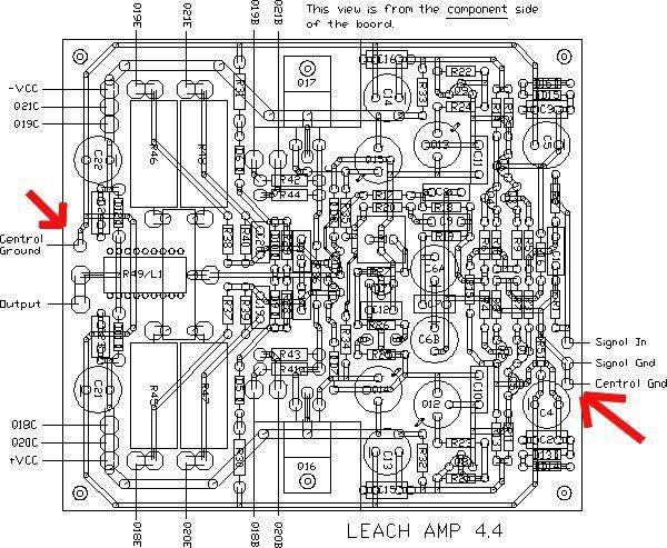

I intent to connect the LS ground direct to the PSU, like any other "power grounds". On the mainboard i see a connection pad for signal input, and a connection pad for signal ground.
I dont see any connection pad on the main board to connect all signal grounds from the main board to anything else. Do i miss something??
Acenovelty, I think my question is not as stupide as you suggest. The boards of all power amps i build have a connection pad to connect the signal ground (maybey with a resistor of 10 Ohm or something) to the power ground of the PSU.
Lets turn around the case: Acenovelty, from witch point of the main board do you connect the signal ground to the power ground (PSU or wathever)?

ground
The amp has a high enough current potential that you definitely do not want to route the LS ground through traces on the main board. The only points on the main board that need ground have a pretty good track thickness, and this should have a stout cable to the HQ ground, which should be a spur from the cross bar between the main caps, which is also where the LS return will want to go.
Stuart
Stuart
Mornin' Stuart,
Eh? Maybe we need more coffee. Don't quite get that?
Think maybe wim is looking for a point to ground the PSU on the board and how does the audio signal get star grounded to it. I surely need more coffee.

grounded
Doh, you are quite right, there doesn't seem to be a hole in the board for attaching a second heavy ground wire to the HQ ground. I was planning to solder directly onto the track underneath and hadn't bothered looking until now...guess people are gonna have to drill a hole...

Hi-
I think Wim is looking for the tie point of the main board to the PSU ground.
I have looked at the main board again myself and other than the input ground, there are NO spots to tie the main board to a ground reference.
I would ASSUME that where the input ground connection point is I could add a 10 Ohm resistor(parallel) and tie the main board to the PSU ground or tie it to the chassis through the PCB mounting screws.
But I would expect the main board would require some type of reference to the chassis/PSU ground for the input signal.

Star ground?
As i remember the reason this was not added is that it does not exist on the original schematics... nor does it on the KSA-100 schematics either...
Unless i've missed something? Is it really necessary? Was there a reason krell left it off? (or every schematic is wrong?)

A good discussion; i think i go for the option RABSTG wrote. A line with a 10 Ohm resistor or something laike that from the signal groud pad on the main board to the main ground on te PSU (the star point of the caps).

in this amp...
... the 'star' ground, is off the board. You need to run the ground return from the LS to the HQ (star) ground, which as I mentioned should be a spur off the main 'bar' between the caps. The board ground, which is also the signal ground, needs to go there as well, with a 10ohm resistor in series if you like.The ground track on the board is huge relative to the currents expected to be moving in it, so there should be virtually no modulation of the voltages from one end to the other.

Just a thought, some connections to the star gnd may result in induced hum.
To eradicate this , especially in the input coupling to gnd, a resister can be used to limit the high currents flowing in the gnd. Any value of 10 ohms to 150 ohms can be employed (depending on the connection) to reduce this hum if it happens.
Ofcourse, you need to know for which points should you have a near zero impedance connection to Gnd and which ones are ok via a resistor...😉
