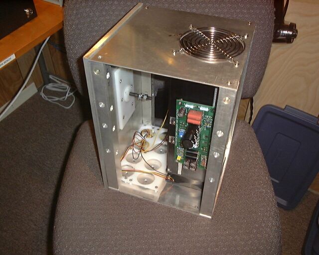

putting case together
Recently went to the surplus store. Case needs top and front panels, but only cost $5.00. Will look nice with some wood side panels. Going to use vertical heat tunnel like the original.
I was going to use 3 TO3 output devices per rail but I see that I have enough room for 4...hmm.....
pic attached
pic attached
