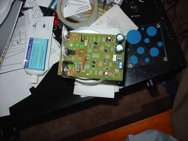

Will i need a heatsink on the bias transistor? (i'm mounting it to the mainboard not the main heatsinks...)??

I think the Bias Transistor has to be thermally coupled to the output devices to track properly?

...should only have a maximum of 4 or 5 volts under even the most heavily biased conditions, so I don't think it will need it's own heatsink per se. It is often mounted on the same heatsink as either the outputs or the drivers, to provide some thermal compensation. As temperatures rise, everything heats up and the overall bias voltage needs to decrease at a similar rate to the decreasing forward bias voltage of the output transistors.

I figured that Krell didn't have the bias transistor on the main heatsinks in any but the very first class a KSA-50's, so i'd keep it onboard... but with a separate heatsink, i mean, it's temp will be fairly constant... i'm going to bias it according to ambient temp... i would have thought this would be ok?Later krell's bias is on the same heatsink as the drivers... Should i bother? Being class A the bias really doesn't change that much, even if it does get hotter, maybe a bit, but if it gets to that point, i'd prefer the bias chip to be unheatsunk and get hot prematurely and lower the bias which will also keep ambient temp down... does that sound feasable?
Otherwise i can remove it from my boards and hardwire to the heatsink?

Traditionally it's put on the output heatsink, but I think probably that attaching it to one of the drivers is good too. For most purposes it probably isn't necessary, but I figure it's easy enough to do.

The bias transistor is unlikely to get hot due to it's internal dissipation, the idea is it is made hot by the heat dissipated in the output stage. Since it is a VBE multiplier, as it warms and it's Vbe drops, the total bias voltage drops, and the quiescent current drops.

"Should i bother? Being class A the bias really doesn't change that much, even if it does get hotter, maybe a bit, but if it gets to that point, i'd prefer the bias chip to be unheatsunk and get hot prematurely and lower the bias which will also keep ambient temp down... "
I am locating mine on the driver heat sink. I am making a one piece sink just like the original has on the drivers. If you don't allow it to track something that is temperature related to the output stage than you also face the risk of thermal runaway in which the output devices will literally melt down their junctions.
When you bias the amp let it heat up over time, monitor and tweek the bias till its at the point you want at its operating temp. With the bias mounted along side the drivers the bias transistor has a definate temperture to sense and should keep the amp in class A at your preset point and track the overall temperature so it doesn't go over your preset bias point. If you allow it to stand free air then there is nothing for the transistor to sense but the free air temp and then'll be much lower that the rest of the amp and probably no relation at all to what the devices are doing. The output stage may just keep getting hotter and hotter and melt down...... this has always been a problem with bi-polor silicon output devices. In the photo the blue heatsink at the top has the drivers on it and the bias transistor.

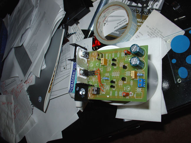

I can always use a piece of copper sheet to "join" the 2 main drivers together and just attach the bias trans to that... that'd work.... i notice that the krell has all the drivers heatsinked, however in our diagrams, etc it only states the main 2 needing heatsinks... I was only planning on heatsinking the main 2 (and now) the bias transistor...
I was planning on just using a strip (about 2-3cm wide) bolted directly on the back of the TO-220 drivers and then have the heatsinks bolted to that.... that was my plan... what is everyone else doing?!

The copper strip is a good choice as it conducts heat very quickly allowing the bias transistor to track even better. I am fashioning mine from a scrap of copper bar that I am going to machine.... the backs of the driver transistors are at opposite sides! So the heat sink has to be machined with a jog at each end so that it still lies straight across and looks good. BTW: Having a silver flash plating over the copper raises the efficiency of a copper heat sink dramatically! Good luck with yours, its a good choice of material.

I managed to get some alum strip today, might use that instead, for a particular reason, it's cheap and quite thin so will conduct heat pretty well (it's about 1mm thick!) and i have little clip things i can use to hold the bias transistor to it, so that should work OK... i think... Now i have to isolate it all!! I am going to be sanding the alloy very very smooth and potentially a little thinner, depending on how rough the surface ends up appearing 🙂
Copper bar, etc isn't as easy to get as i thought, i will have to ring around during the week if i go that way!
I'd mount the bias to the main heatsink, but having fans and being large it's going to take quite a while to get hot... whereas the drivers, etc will get hot a lot faster on smaller heatsinks and no fans... I don't mind running wires, etc but i'm trying to keep the boards as compact as possible

I've got the other 4 boards to do in the same way now *shudders*... Thermal paste makes a massive mess, i used as little as possible, but i ended up spreading it everywhere!!!

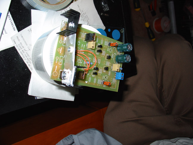

I know due to matching, etc that one driver will most likely be hotter than the other - but instead of joining both with the alum/copper/whatever can we "hook" the bias transistor to one heatsink of one driver alone? I mean, wouldn't both the drivers increase temp at a similar rate... so that could make my "mess" a lot neater 🙂

If you bolt a 3"x1/2"x1/8" (3mm) piece of Al, or Cu to the fronts of the respective tabs, it runs between the 2 transistors quite nicely, one in front and one behind. The heatsinks bolt on the back o' the tab as usual, and the bias transistor bolts to the bar in between...As a convenient extra it also sits high enough above the board to allow the I/V limiter to still be present for them as want it.
