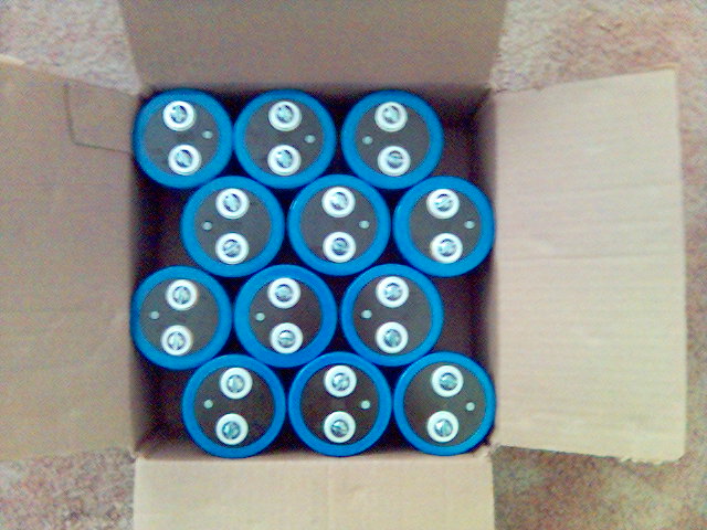

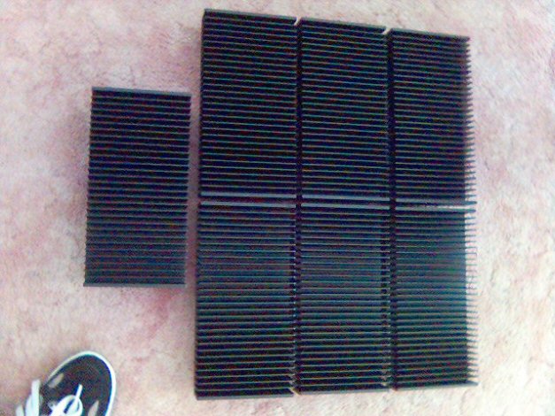

ooh, look at the awesome...
Can you believe the talent of the person that packed those caps?
Santa was slow, but apparently kind...
Stuart
Stuart

I received my boards. Thank you. I built up one channel. R 24 @ 2.7 K seems to be a good starting point for the bias. It has only 2 sets of outputs. Changing the bias between 1.5 and 2 amps @ 34 to 36 volt rails. The heatsinks should be good for 125 to 150 watts with a 20 to 25 deg. rise. I hope to have the other channel done by the weekend. Then listening, testing, and tweaking.
