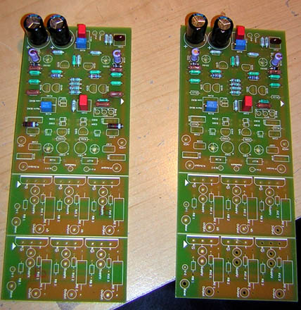

Updated PCB-layout will be made and uploaded when we are sure that there are no further corrections 😉
Got my boards today, i love them, they look excellent!! I might start with semi's (i know, not a good idea) but it's what i've got here to install now, so i might go with it 🙂 I'm doing one tonight, at least placing the parts, maybe not solder (as i'm waiting on 2% silver solder, it's worth at least 400 points towards better sq!!! lol)... But having a go with placement....
What heatsinks do we need on the drivers/bias etc???

NUTTTR said:Got my boards today Aaron
Wow, Australia in 7 day's!!!

Has anyone received damaged boards? All shipments were insured.

Hi All-
I "suggest" and this is only a suggestion, that you snap off the output boards before you start component assembly...
It can be done post installation, I just find it a lot easier and less stressful when the boards do not have parts that can be damaged.

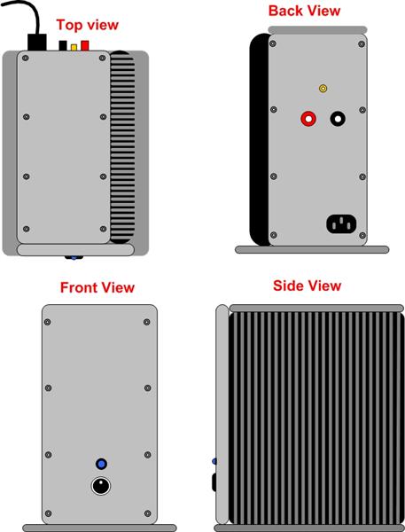

Hi All-
Is anyone out there not “thermally challenged” as I am and have time to answer a question?
The question is how long does the extrusion need to be for a single channel?
I am planning on building 3 mono block KSA-50 Klones with a heat sink extrusion from the following page.
Item # MM10332. Fourth one from the bottom of the following page.
http://www.mmmetals.com/pages/extru...back_heatsink_aluminum_extrusion_4_and_up.htm
Here is the actual link to the item:
http://www.mmmetals.com/extrusions/drawings/mm10332.jpg
I will be using the heat sink as one side of the amp, the other side will be ¼” thick, the front will be ½”, and all other sides will be 1/8” thick Aluminum.
Below is basic example:
EDIT: Note drawing is NOT to scale.. Size will depend upon the answer to the above question.
