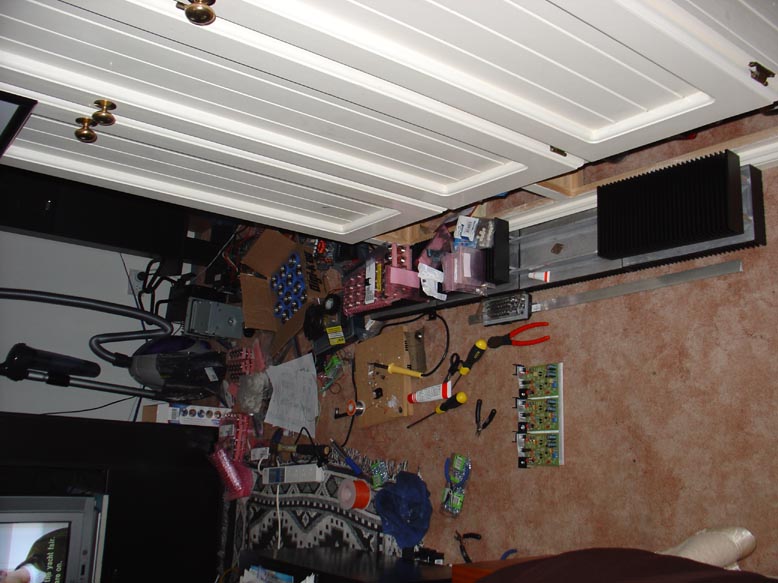

Here's the boards...
The emitter resistors have been neatly soldered to the other side of the boards to facilitate the fitting of the metal between the drivers... Although not 100% neat, i think it will work very very well 🙂

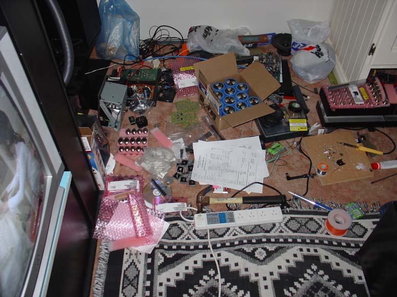

NUTTTR,
Bless this mess.
Just how many transistors do you have on the floor?
Shall we begin a collection here for Aaron's proper work bench?
I will begin with a modest donation of $5.00 USD.
My little workbench is in a similar mess from too many projects at the same time. But I get to stack stuff under it.

Personally I like working off a carpet too. I have 2 benches but they are not fun.... they never have enuff space. PLus screws dont fall off the edged on carpets. 😀
I don't mind the screws falling off the bench so much as that last 82 ohm 1% resistor that ends up bouncing off my knee into a box of junk under the *@%! bench. Looking for it forever. Guess I'll never have enough space either. Good thing I keep a high WAF for this hobby.

Solder sticks better to carpet than hard top workbenches too!
My wife gets soooooo mad when she vacuums around my desk...

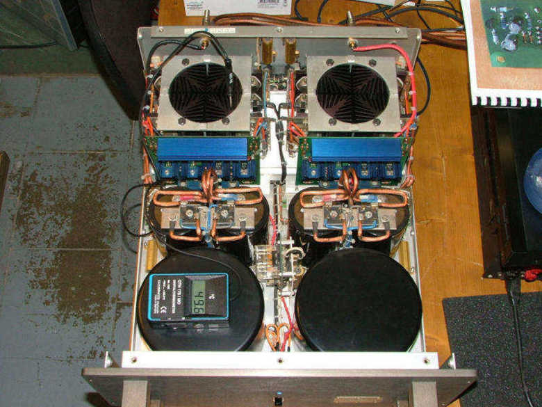

Hi Guy's
Yesterday evening I had the opportunity to listen to a Krell KSA100 that my friend recently acquired. Although it was hooked up to a set of small monitors (testing purposes) you could hear that this is a great amplifier. With all the information I gathered from our little get together yesterday I think I will also go for the forced cooling on my Krell-Clone. As you can see in the picture, the amp has a working temperature of about 50°Celsius. The 120mm fans that are used you can hardly hear. In this case the dimensions of the heatsinks can be reduced big time (and cost). Still not quite sure which output devices I’m going to use.

GeWa said:Hi Guy's
Yesterday evening I had the opportunity to listen to a Krell KSA100 that my friend recently acquired. Although it was hooked up to a set of small monitors (testing purposes) you could hear that this is a great amplifier. With all the information I gathered from our little get together yesterday I think I will also go for the forced cooling on my Krell-Clone. As you can see in the picture, the amp has a working temperature of about 50°Celsius. The 120mm fans that are used you can hardly hear. In this case the dimensions of the heatsinks can be reduced big time (and cost). Still not quite sure which output devices I’m going to use.![]()
Cheers
I have a feeling the Clone (A Mk.II) will sound better. Just don't skimp on the Power supply and you will love it more than the KSA-100!

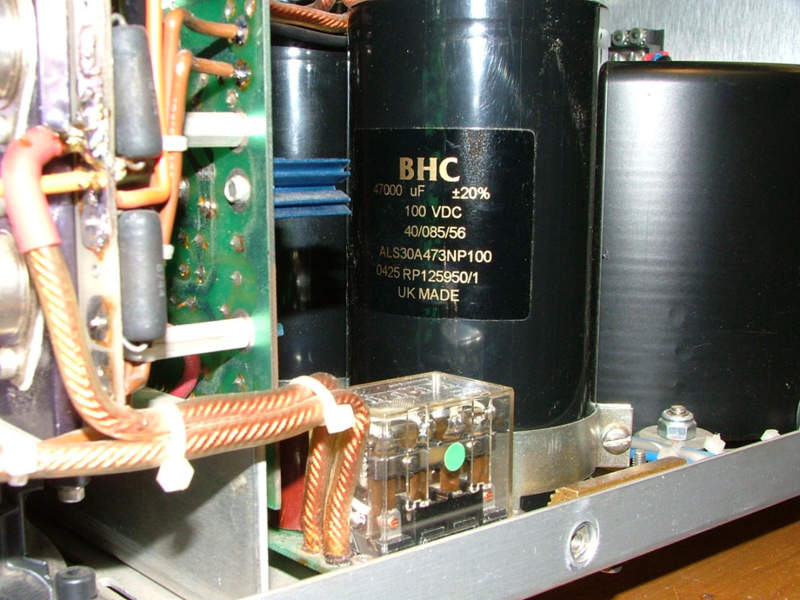

Hi K-amps
If I can still get them I will be using 2x 47000µF/100V caps per channel. (see pic) My friend also has a transformer I can have for my project. It has 2x 24-0-24V secondaries and is rated at 1500VA. With this transformer I will have ±35V rails.

I know it's a mess, but i've no room left to work almost! Solder does stick brilliantly to carpet, i'm lucky this place is rented!
