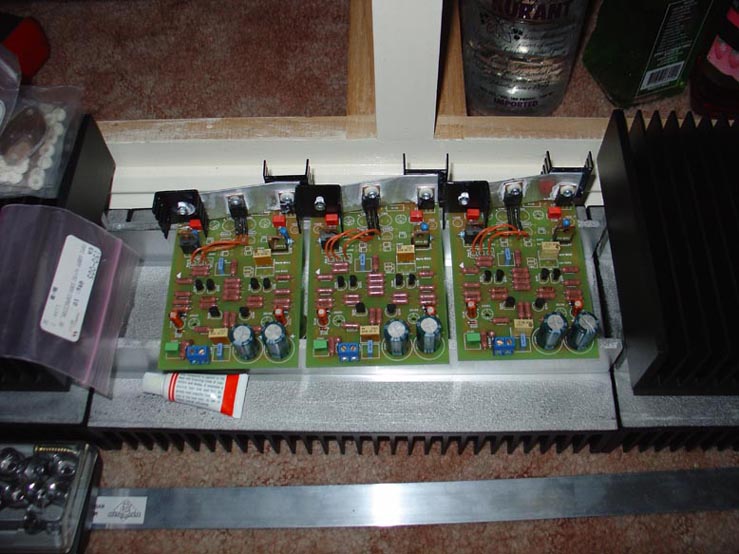

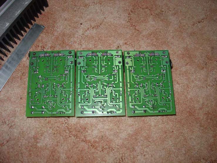

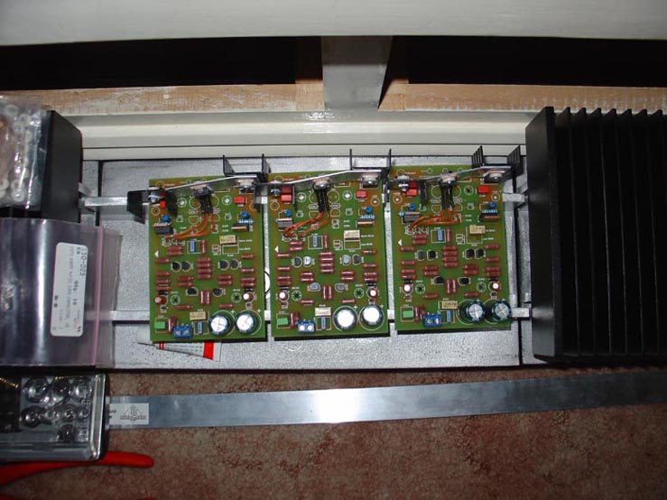

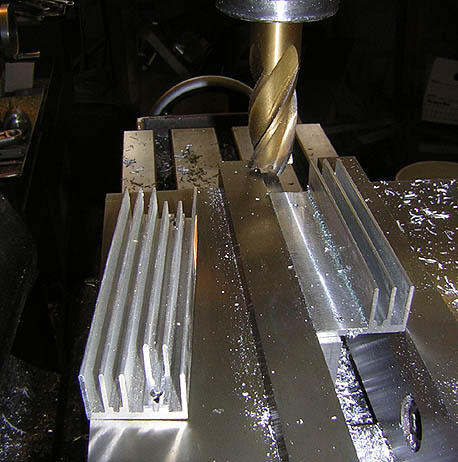

I found some surplus heat sinks today that allowed me to just about duplicate the original Krell heat sink. I machined back some of the fins and then repositioned Q-110 so I could keep the heat sink straight with the PCB edge. One driver is on each sode of the sink and C-108 will be on the bottom of the board. Its worked out well so far although this is the reverse of the original Krell arrangement. The bias transistir is in the center of the heat sink and will be jumpered over to its connections and insulated with heat shrink. So hopefully things will track well...... The NTE transistors are just temporary till the real stuff arrives.

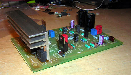

I finished one amp board this morning.Powered it up with my bench psuat 30 0 30.I preset the Dc offset pot in the middle 2.5 k and it wasnt far off.I set the bias current at 2.5 Amps to start and managed to get the main heatsink to 65 degrees.I put the bias transistor on the main heatsink as ive done before with other amps ive made.q109 and q110 are getting pretty hot so think i'll have to find some larger heatsinks for them but on the whole the amp works well.

Anthony, You say 2,5 A bias current. You mean 0,83 A per output device? (if you use 3 outputdevices per rail conform jan's schema).

For Capacitors 105 and 106 i used a 33 PF polystyrene cap.I think thats all i changed from Jan's part list, I used 1 Ohm base resistors on the output boards.

Where did you get the batch of heat sinks? I see several lined up on the floor. Also, will you be using one heat sink per channel? That is about the capacity they looked to be able to handle.
