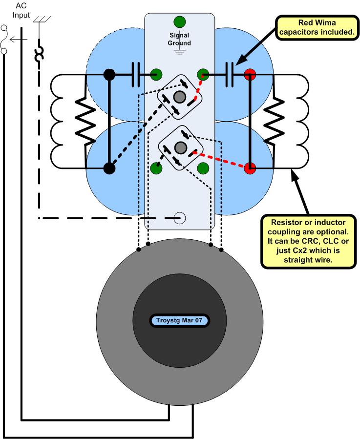

I drew this diagram of the pwr supply for the people who bought my Krell that I had to sell.
Is it worth putting in the Wiki for an example?
