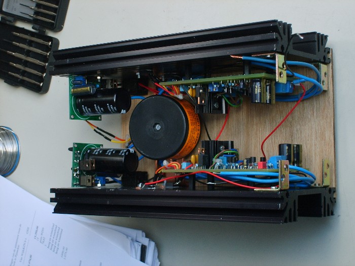

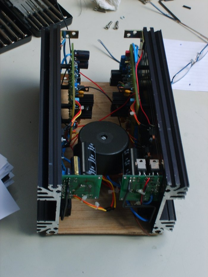

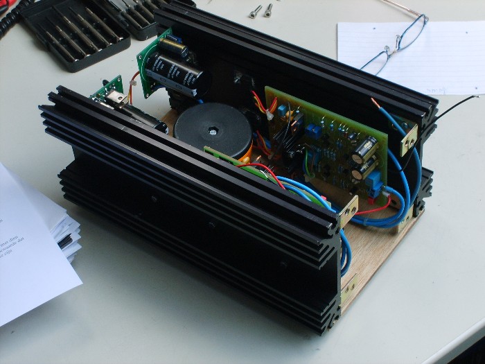

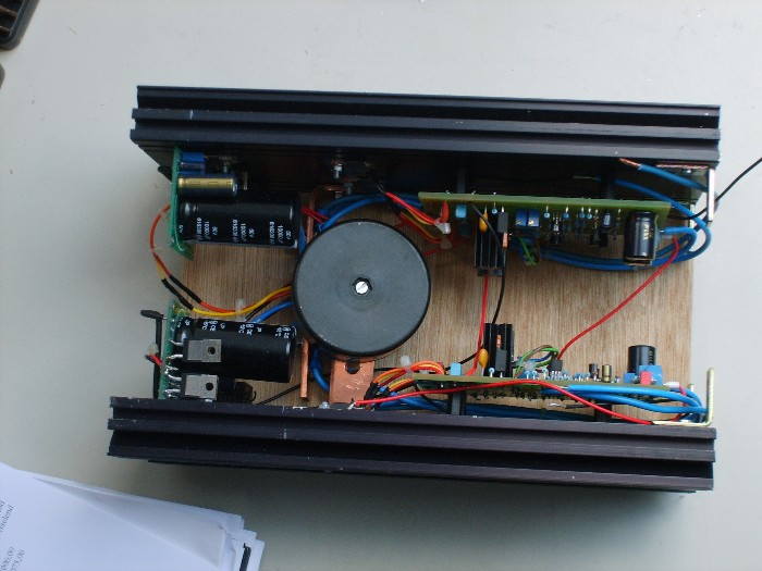

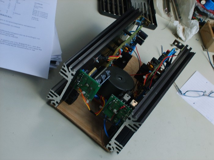

Trafo 2x25VAC 15VA, rails adjusted (regulated PSU) to +/-30VDC, 450mV over each 27 ohm resistor.

Hi Andrew, the purpose of this minikrell is a headphone amp or small poweramp just like Troy wanted.
So with 450mV the bias is only 16mA and seems a nice class A workingpoint to me.

This weekeind i will turn up the voltage across the 27 ohm resistor to 1 V (as i sayd earlyer, it is 450 mV now).
1V is also the voltage across the 27 Ohm resistor on my finished Krellclone with outputboard.
