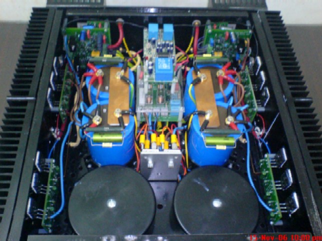

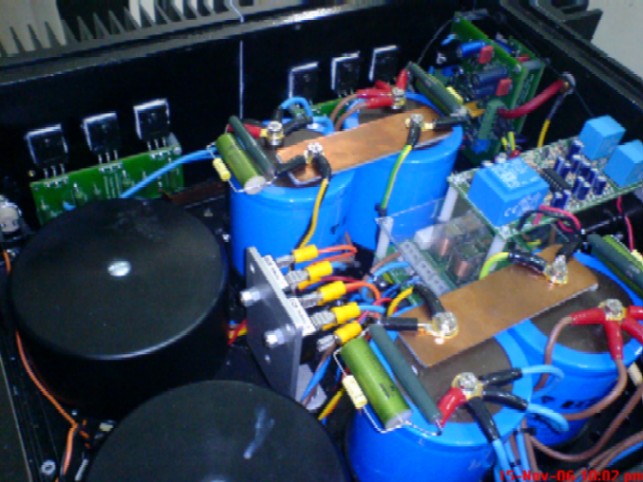

Looks good
Farl
How does the amp sound.
Visually it looks very good.
The long leads from the PCB to the drivers- is a slight concern to me.
Jozua
Cape Town
South Africa
Farl
Jozua
Cape Town
South Africa
Every time I see another finished, I get a nice warm glow inside!
Well done. How much bias are you running with those heatsinks?
Bias is 300mV with +/- 41 vdc power supply. The temp will reach 50 C with an ambient temp of 25 C.
Regards
are your emitter resistors 1r0 or 0r68?
What dissipation are you putting through each pair of sinks?
Those sinks look like 0.5C/W. and a pair with temp de-rating probably come out at near 0.3C/W.
If you keep the sink at 50degC, then the average Tc will be about 55degC and the maximum (for the worst transistor) just under 60degC. The plastic packages should be OK at that or just a little higher.
