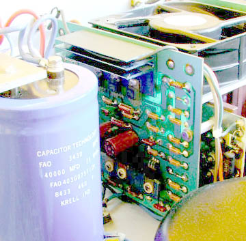

Entirely possible for the bridging.. the thing on the outside has a slot so perhaps it's a switch that has to be turned with a screwdriver. Neat little trick but I wonder how the noise would be..
Sorry Mark, no FET's on this beast - and upon request from Krell its serial number was confirmed as a Mk2. The only semiconductors per board are:
2x 2SC2240
2x 2SA970
2x 2SC2238
2x 2SA968
2x MJE15030
1x MJE15031
2x zeners (not sure of the voltage yet)
2x diodes (probably 1N914 or similar)
Capacitors from what I could see was just the normal input RF cap, Miller caps, 100nF slowdown cap, feedback caps and then the weird 2.2uF. Resistors are normal Dale, and all I could get to with the meter were values corresponding to the clone's. Close to the input there are two resistors per board tack-soldered, one in a pretty little sleeve.
Gauging from that it would probably be easier to mod a KSA50 clone board than a 100.2 one. The rather high DC rails was a bit of a surprise, AFAIK most people went for mid-30's.

Mark
Hi Mark
I think that picture is of an earlier model as I am under the impression that the later Krell models all had the fan mounted at the bottom of the heatsink.
Nice to see you back in the "saddle".
Jozua
Hi Mark
Jozua
Mark,
Nope the four devices on the lower heatsink are all 2SC2238 and 2SA968. If the circuit diagram is the same as the clone (which so far seems likely), then the extra pair is used instead of the clone's MPSA42/92, and can the clone be adapted with a bit of ingenious soldering and adding the extra bobs&bits. Even if there were some other changes to the diagram there are enough similarities to convert a clone without molesting the board too much.
Raising the rails would also help perhaps, there must be a reason why Krell had gone so high for the 50Mk2 - after all, those 75V caps are the same as used on the 100. Did anyone experiment with different voltage rails at the same bias?
Jozua, the 30V rails on your clone is almost 40% lower and sags a lot under load so in fairness the power supply isn't on par.
Thats interesting! My Klone is running with +/- 40 volt rails. Clip point is a bit over 75 watts @ 8 ohms. I have it biased to 50 watts class A.

Nope, that's not what's going on in the Mk2:
1) Jan used 2SC2240 & 2SA970 for the input stage; same as the original and actually all the other KSA's I've ever come across.
2) Jan used MJE15030 for both driver (Q109&Q110) and pre-driver (Q107&Q108). The Mk2 use these only for driver. Now we know from the KSA100 Mk1 and Mk2 that Krell used 2SA968 and 2SC2238 for pre-drivers, so that accounts for that.
3) This is where the similarities stop. The differences from here on are that the Mk2 has an extra pair of 2SC2238 and 2SA968 (absent on the Klone), while the Klone has the MPSA42/92 (absent on the Mk2).
Since so many other variables are the same such as the 1k5 and 24R resistor values I measured, it may be possible that one should just replace the MPSA42/92 (and maybe pre-drivers too) with 2SC2238 and 2SA968, but as I said there are other sinister tack-solderings also going on that is perhaps not documented (refer to the 20pF cap in the feedback on the 100 Mk2). Furthermore I'm not sure if the zeners would still be 27V with the same resistor values with the 49V rails.
I'm not sure when, but I've to do some restoration on the boards sometime and will draw the entire new circuit diagram. Getting the actual values for e.g. C105&106 will also be nice to build the amp exactly as the DanMan intended to
