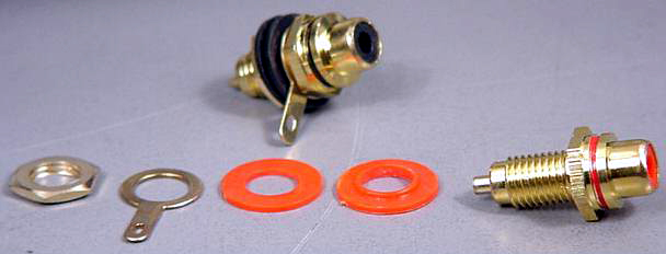

ryssen said:Should I isolate the input RCA´s from the chassis,how have you done?
Shoulder washers.
http://www.apexjr.com/images/RCASPEAKERJACKS.jpg
