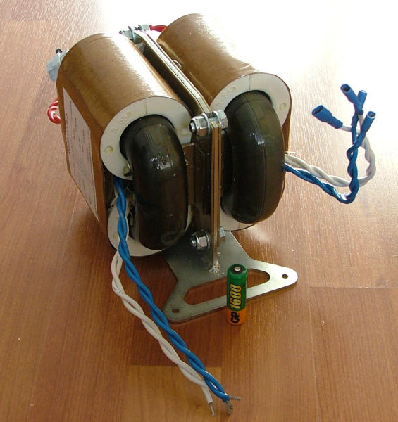

This is just to get this thread back on the first page and get the link to the building wiki exposed.
My supports for the R-Core transformers are ready. The attached picture shows the support for the stereo version. I just put the AA battery in front of it for size comparison 🙂
Regards
Regards
