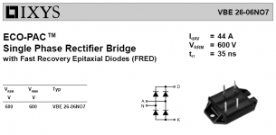

Any suggestion what might be a better rectifying diode to use on the Krell instead of a regular bridge rectifier ?
MUR type, BYW99 maybe ?
I bought a pair of IXYS VBE26-06NO7's (pdf data sheet) a year ago from somone here on diyaudio.com (at least I think they are those, but don't have them sitting here with me) and plan on using them in an upcoming Aleph X. Click here for some options of IXYS high current bridge rectifiers using ultrafast diodes (similar to MUR but 4 of them).
Don't know if they are any good but they sure look impressive, and I'm not sure how one is supposed to connect to those super sharp dangerous looking spikes on the package.
(I would have used these on the krell clone but they are larger than the standard cube full wave bridge and actually would not fit on my floorplan)
