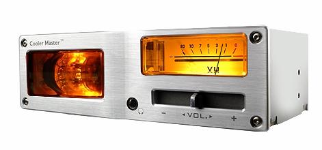

Oh, another thing. As most of you (i think) I was REALLY impressed with LGreen s creation with the fancontroll, and who wouldn't be?
So I found This , It doesn't have a warningsystem and auto-shutdown but it looks really cool

kmj said:So I found This , It doesn't have a warningsystem and auto-shutdown but it looks really cool
Hmm, that link is for what looks like a dodgy set of computer speakers.

Thought everone agreed that without protection circuitry it was not very safe to test into <2 ohms?? Should I go for it?
KMJ- that will probably work, but keep looking, you may want to use the latest and greatest
EDIT-- the following is a sound controller so it won't work for controllng the fans, but its cool anyway becuase of the vacuum tube. (see attached), Musketeer 3. People actually buy this to ADD distortion. Go figure.
Also, the prices on these computer items depreciate rapidly, and supply runs short. Mine is 1/2 the price it used to be. It lacked a disk/software so I was sure it could work stand-alone, just needed a +12 and +5 volt power supply.
I say try it out, other than adding a ton of noise to your system it should be great (just kidding- run it off a separate supply/transformer and should be fine).
Oh, I'm not looking for the newest and most advanced stuff, I just like those gauges
ok
Yeah, they have a nice retro look to them. A lot of these controllers are not symetrical...did I spell that right? That one is and should be perfect.
