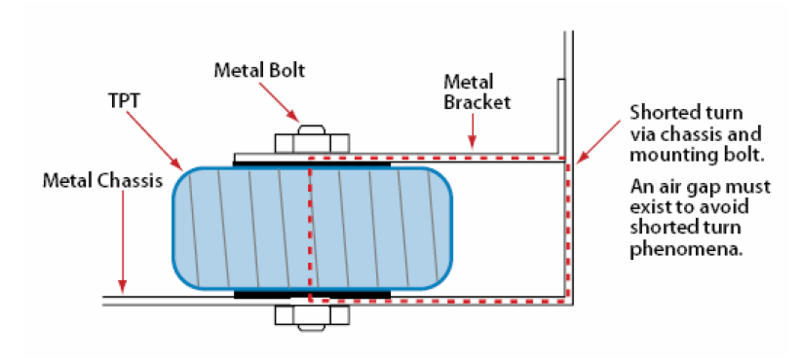

I wanted to tell of something I learned when putting this in the case. Fist of all I tried using a long brass bolt as the hold-down for the toroid as well as the star ground. I got a horrible hum. In the pics you can now see two bolts sticking up through the top of the filter caps. One still goes all the way down to the bottom of the case and serves as the mount for both the toriod and the filter caps but it is isolated from the ground plain on the caps. The other bolt only conects to the ground plane and serves as the star. No hum at all now.

If you look at the attached picture you can see why you got that terrible hum in the first place. I used the picture from BrianGT's manual because that explains very well how to bolt down a toroid transformer in a casing. Always make sure that you never ever create a shorted turn with the centerbolt.
Regards
Regards

Oops, I forgot to insert the pic of the drivers next to the intake holes, so I'll do it now.
I was really amazed at how big of a temperature drop I got on the drivers by doing this. As I was testing this all week before I built the case, the drivers were running between 70c and 75c. I figured this was too high so I took that into consideration when planning the intake for the case. Worked like a dream. Like I said earlier, the temp dropped to 45c due to the air flow being forced over them.
I was wondering what happened to that extra voltage. All week while testing this amp out of the case, I was reading about 42VDC rails. After installing it into the case and adding the CL-60 thermistor, I am anly reading a little over 40V rails. This explains it. Thanks.
Sorry Mark, that case took me two days to make and about $60 worth of materials and I'm still not satisfied with the way it looks. I would hate to try and make one for someone else. I need to sleep at night.
I had seen that diagram before with the toroid. I guess I hadn't realized that the wires were creating the loop that is indicated in the diagram with metal plate. It was a lesson learned and I only mentioned it to save someone else from going through it too. THis amp is very quiet now. I still may add the 100uf resistors across the bridge and incoming current, that had been suggested in an earlier post. I bought them and then forgot to install them. I may do that tonight when I get home.
Blessings, Terry
Blessings, Terry
