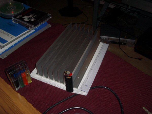

Sorry. those heatsinks are very thick and the transistors face opposite each other, so they twisted when it was installed. After months of looking it was the only heat sink I could find with two smooth sides suitable for mounting opposite facing transistors. Can't do anything about it now but they should run cool and live long.
I did file the edge- you should have seen it before! guess I should sand it to make everyone happy.

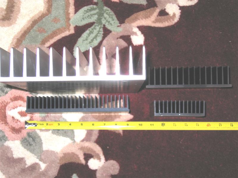

kmj said:Will one of these/channel do or are they to small?
Are you planning on using them external or face to face with a couple of fans on them. If you use them externally they should be mounted with the fins running vertically. I think you can lay them horizontally if you stick a couple of fans one one end.
Others know more than me though. I think a couple of the folks here are using sinks like that with fans. Maybe they can chime in.
Blessings, Terry
I thought that i could use them externally and use them as the shortsides of the chassi (horisontally) and them add some fans inside to make an airflow.
but perhaps it's best to buy a pair of them tunnels from apexjr instead
