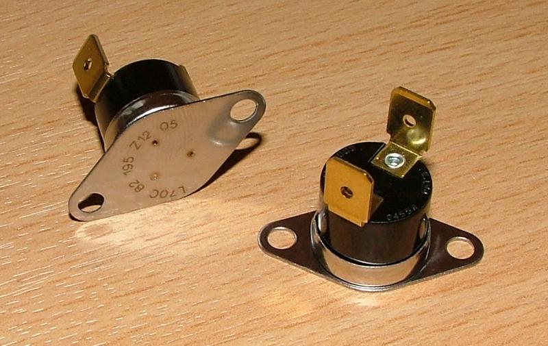

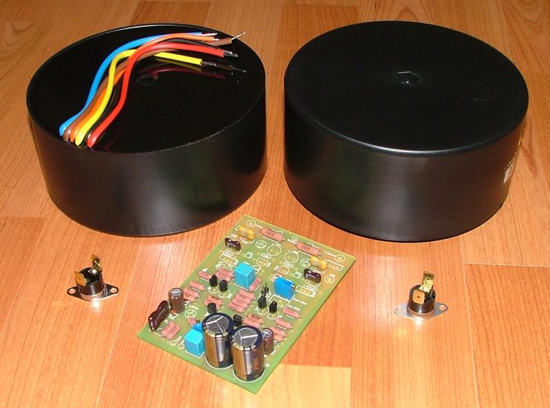

GeWa said:The PCB is just there to show the size of the transformers.
I notice another thermal breaker on the block.
Can't you at least give us simple people the specifics on those greatlooking transformers, dear Walter ?
Yes I can dear Jacco. They are plastic potted toroids with 2x 0-25V secondaries and rated at 500VA. I got them from RS-Components for 52,90€ each. The stocknumber is 223-8897. While I'm at it, the thermal breakers are also from RS. It's an NC type which opens at 70°C and closes again at aprox. 55°C. Stocknumber is 339-308 and costs 3,67€. I will be mounting one on each channel and connect them in series with the power switch. In the event that the heatsink, for some odd reason, would reach 70°C the whole amp will shut down. (better save than sorry)

Thermal Switch
Could I put one of those bi-metal NC thermal switches in-line with the AC inlet to open up in the case of overheating? I think the equivalent is the 317-1084-ND from Digikey Page 1179 (datasheet here) which is NC and opens at 70 deg. C.
Seems like a really good idea.
Used in a number of production models, first one that springs to my mind is the Norwegian Electrocompaniet AW250, think Mr. Pass used it as the only protection in his Forte Audio models.
