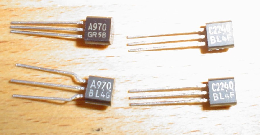

Once the 6ma CCS is in place, none of the front end resistors are power stressed. Without it, the whole front end will die at more than about 60v rails.
Once the front end voltages are held stable the voltage over the rest of the resistors is held quite constant regardless of the supply voltage. Thus the majority of the extra dissipation is in the transistors, and because of this the pre-drivers (q107/108) will need to be heatsunk for complete reliability.
Once the rails are beyond 60v the 2sa970 and 2sc2240 don't have enough Vce to be completely safe, and I substituted the mpsa types for my tests.
Stuart
