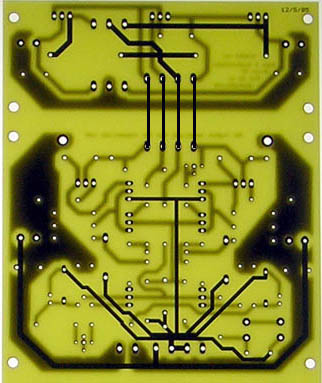

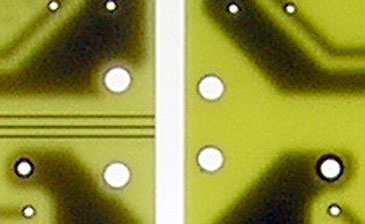

THE PROTOS ARE IN! The improvements do appear to allow mounting the boards in a much safer manner. The foil has been moved away from the mounting holes and the mounting holes have been moved outwards as well, so thats much, much better. The wire holes that have been changed to larger holes will now accomodate #12 stranded silver plated teflon wire with ease😎. All in all with the few changes made the new version should accomodate everyones wire type usage. I will post side by side photos of the first version and the revised version later on tonight so check back here.

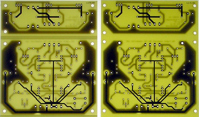

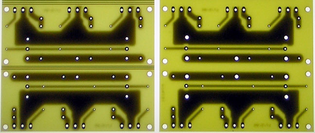

I would like some feedback from everyone on how they look....... Want to be sure everyone is happy with them. I will builf one up tommrrow and is all is well the order will be placed on Monday. The 2 for 4 deal is still good till Aug, 4th so we will have the entire run back in 2 weeks from that time. The PSU boarsd willa lso go in via Brian GT on Monday and will have a similar production turn around time. The amp boards will be 2 oz copper and the PSU boards I am pretty sure are3 oz copper.
The first OUTPUT BOARD prototype is on the left, the final is on the right.....
Its ok to breath now!!
What makes this board so nice is that you can leave the main/driver board together(assuming enough heatsink for the drvices) and just jumper the traces over as shown. Or if you want you can snap them apart and easily mount the drivers to the main heat sink. They do run pretty hot.

I'm assuming that the real boards (or am I missing something from the pics?) will have markings for placement of the components correct?
Cool!
Mark, I take your point about the BOM, but it does show how robust the design is for a little variance in values. The boards look very nice, though I don't see the markings for the scoring.
Noob, these are proto boards, with no solder resist, scoring or silkscreen. The production boards will have all three. Unfortunately not in pink...🙁

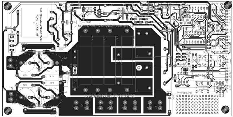

I completed my Softstart & Standby PCB. It is single side. It also includes an Main DC Filter. This is a low res file. I can send hires pdf if interested. I'll use it into my KSA50. In fact I was waiting for it before finishing the amp.
Nice design but I don't think there are that much electronics in the entire Space Shuttle! I'll stick with the CL-60 myself.

Yea, they left the scoring marks off for some reason and thats the only question I have for them on Monday when I place the order. Can you double check the file at your end to make sure they are still there.......
Thanks!
Mark
Mark A. Gulbrandsen said:Yea, they left the scoring marks off for some reason and thats the only question I have for them on Monday when I place the order. Can you double check the file at your end to make sure they are still there...
Yes, they were in the archive, the file is Gerber format, and called KSA50II.mil. I've attached it here as well, just in case
