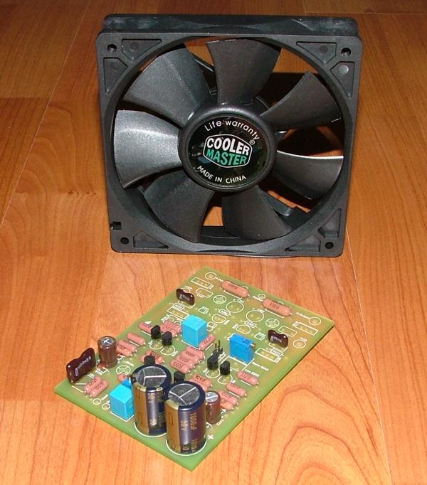

Good news!
I stopped at the hobby store on the way home from work and bought on of these.
I checked the temp of the output devices at 300mV with the small fan and got 40c. So I cranked up the bias to 400mv across the 0R68 resistors and I'sitting right at 52c on the devices themselves. I guess I must have tender fingers cause I sure thought they were hotter than that. I'm going to let it run for another hour or so and check again but I'm pretty happy right now.

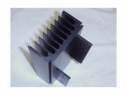

Apexjr is selling heatsink tunnel w/fan for $25 per pair.
http://www.apexjr.com/images/APEXJRTUNNELHEATSINK2.jpg
Mark A. Gulbrandsen said:Where did you get those from? Is that an off the shelf sink?
Mark
They are a standard Avid Thermalloy extrusion. I bought a dozen of them off of eBay. They are 10" in length and in pairs form a 4.75" square air box. I machined off the tabs to maximise the area to mount flatback devices.
Regards
Anthony

Terry 400.0mV puts you right at 50 watts class-A. One word of caution with those IR thermometers, keep the horizontal. If you make readings holing it vertical pointing down at the heatsink, the warm air rising from the heatsink heats up the polycarbonate covering of the IR sensor thereby giving you a false reading. The device is calibrated to measure with the plastic cover not being subject to non-ambient temperatures..... at least thats how mine acts.

Actually that 52c is the reading I get pointing the meter directly at the transistor cases. The heatsink is only reasding between 35c and 40c. Maybe I should get another one tho check it against. It reads 33.2c when I point it at my skin.

Terry, I'm glad you realized that its not as hot as you thought!
One easy thing you can do that I have not seen mentioned here is to add a second fan so you have one at the inlet and one at the outlet. I'm in the process of doing that myself. You can improve airflow and turn down the speeds to make them less noisy. If you are tight on space there are narrow (10-15 mm thick) fans out there that should fit.

Mr Green,
performance of a fan differs for sucking or blowing.
With one fan blowing, the other sucking the air, one of the two fans will be working much harder, and will wear down a lot faster.
You may experience a substantial noise level increase with that setup, far more than the 3 dB for using two fans.
Stacking them is more common, i posted a link to an article a number of weeks ago:

Interesting, I was wondering about this. I've got the ability to control each fan's speed independently so maybe I can get them even. Plus, if each one is only working at 75% of its operating voltage, even if one works harder than the other, say up to 85%, it won't wear out faster because its still operating less than spec anyway.
