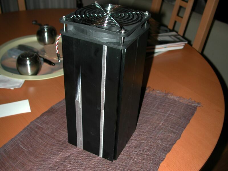

Terry,
thermally speaking, running few devices on a big heatsink is the same as many devices on a small sink.
As Andrew mentioned, temperature of the output devices is 10-15C higher, if your sink is at 50C the die of the outputs is 65C at the highest.
Suppose your heatsink is 50C with your settings.
If your rails are 40Vdc the total dissipation for the 12 devices is around 140 watts (200mV/0.68= 0.294 amp per device)
At 25C ambient thermal resistance of the sink would be something like 0.18.
Which is quite good for the size of the sink and the low airflow rate of the fan you use.
Based on those numbers you can run it up to about 30 watts in class A, temperature of the devices would be 87.5C, temperature of the sink some 65C.
65C for the sink would not be too high to hurt the output devices.
It is too high for other components placed next to it, especially capacitors.
Compared to the real Krell you are using 1 sink arrangement for 2 channels, and the rail voltage you employ is higher.
If you had only 1 channel on this sink you could probably run it up to 75 watts in class A with a sink temperature of 55C.
With 12 devices for 2 channels its either lowering the bias, using lower voltage or increase the airflow with the bigger fan.
At 200mV in 0.68R you are currently running it a bit over 10 watts in class A.

Terry at 200mV
Inputs
Number of output devices: 3 Pairs
Voltage rails (per rail): 41 volts
Emitter resistance (per device): 0.68 ohms
Bias voltage per Emmiter resistor: 200 mv
Idle bias per device 294.1 mA
Speaker ohms 8 ohms
Results
Idle bias per device: 0.294 Amps
Total Amplifier bias (per rail)** 0.88 Amps
Total Amplifier bias (both rails) 1.76 Amps
Total Dissipation (per channel) 72.4 Watts
Dissipation per device pair at idle 12.1 watts
Class-A output: Peak 24.9 Watts peak
Class-A output: RMS 12.5 Watts RMS
Efficiency 17.22 %
He is dissipating about 145 watts in that whole rig, which should be ok for a small wind tunnel. However he is getting only 12.5 watts class A.

Hi Andrew,
Thanks for your help. I haven't measured the rails under load. I will try to do that this evening. They are right at 42V at idle. I have measured that. I had thought about trying it as a mono block. I could do that fairly easily I think by just disconnecting the outputs on the one PCB and running a couple of jumpers. I may try that as well. I just cut out all of the panels for the case last night. It won't accommodate another heatsink assembly. If I can't get this to work I would have to start all over to make a larger case. I don't really want to do that.
I mounted the larger fan on the amp last night and was able to turn up the bias to 400mV across the .68R resistors. It got pretty hot to the touch but I was able to leave my fingers on the heatsink for 3-4 seconds. The fan noise is completely unacceptable though. I wish I had known that this transformer was too much for this amp before I bought it. It wasn't cheap. I have other large flat heatsinks that I had planned to use with the flat pack transistors but when I posted a pick of this heatsink setup everyone said it should work fine. I guess you have to pay to learn.
I will stop at a hobby store on my way home today and see if I can find one of those heat gun meters. Looks like I'm going to need one.
Hi jacco,
Are you saying that 87.5c is OK for these output devices? If that the case, I'm probably all right running the bias higher. I was running the amp into my nearfield speakers last night while I was testing and they are 4ohm, not 8. My JBL 4425's are rated at 8 ohm but they measure 6 ohm. That may explain the higher temps as well, I don't know.
Oh, and, I didn't think about dropping the voltage going into my P101 to try and get them closer in output. I'll try to do that and see if they are more comparable. Folks shouldn't sell the P101 short though. To my ears, it is a very nice sounding amp. Certainly better sounding than my stock Haflers.
Blessings, Terry
