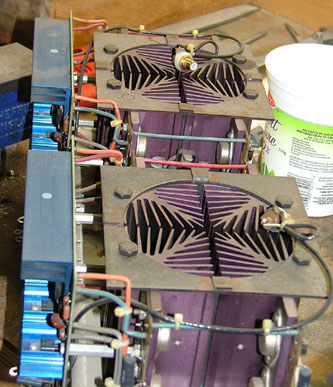

OK, here's what I have at the moment. It has been running for about two hours with some very nice sounding jazz pouring out of the speakers. I just measured the bias and have 200mV across the .68R resistors. I can only leave my fingers on the top of the heatsink for about 8-10 seconds before its to hot too take.
Too hot?
I already have a fan on it running full time.
Thanks, Terry

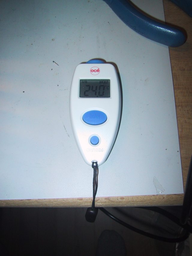

Thats not too hot😉 Why dont you guys, get yourself an IR thermometer? Cost next to nothing and is really handy for this kind of work😉 It will also take your own temp. if needed😉 In case you have a seriuos attack of DIY fever😀 I checked the readings of this little gadget with my Fluke 87 temp readings, and it seems precise.I can only leave my fingers on the top of the heatsink for about 8-10 seconds before its to hot to take.
Steen.
Terry,
It sounds like you need a different heat sink arrangement for your amp to be able to do the 50 watts class A out of it. I would think that the Hafler sink that you have would be enough but it must not be very efficient for some reason or other. If you have two sinks then one channel per sink might be a safer arrangement. Are you using .68 ohm emitter resistors or lower than .68? I am just using two plain ole flat back heat sinks(nothing fancy) that I got off of E-bay for 35.00 a pair and they work great with a pair of 4" fans running at a little less than half speed I can sit at about 50 deg.centigrade withn just about 400mv across the .68's.......
Mark
Mark

I'm wondering if it's the 30-0-30 transformer that's the problem. THis heatsink looks almost just like the ones I've seen in pictures of the Krells.
I have a more powerfull fan but it is louder.
I'll try it and see if it makes much difference.
Blessings, Terry
Actually now that I see that lower photo I think you'd find that the sink that Krell used has quite a bit more square inches of radiating surface inside the tunnel. Youf fins are large and then small.... if they were all large fins then you'd be correct and yours would have the same or more square inches of radiating area.
