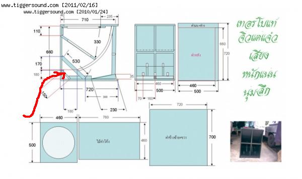

sir jojo,
looks like the hd 15''
now i understand why hd 15 sound is impresive loaded only with 1530

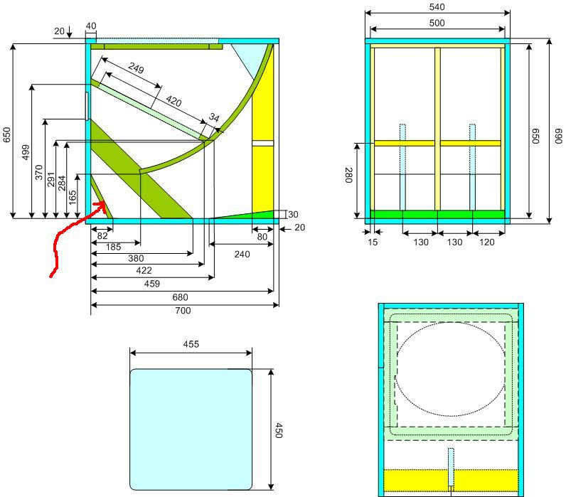

sir jojo,
which of the two sound better?the degree of the piece pointed in red,how critical these in the design🙂
wsx question
what is hyperbolic expansion law and large linear excursion🙂

TSW118 is a hybrid hornloaded 4th order bandpass cab ...WSX is a sealed horn loaded cab...hyperbolic because it is somewhat has a expansion rate of a hyperbola of a cone?...

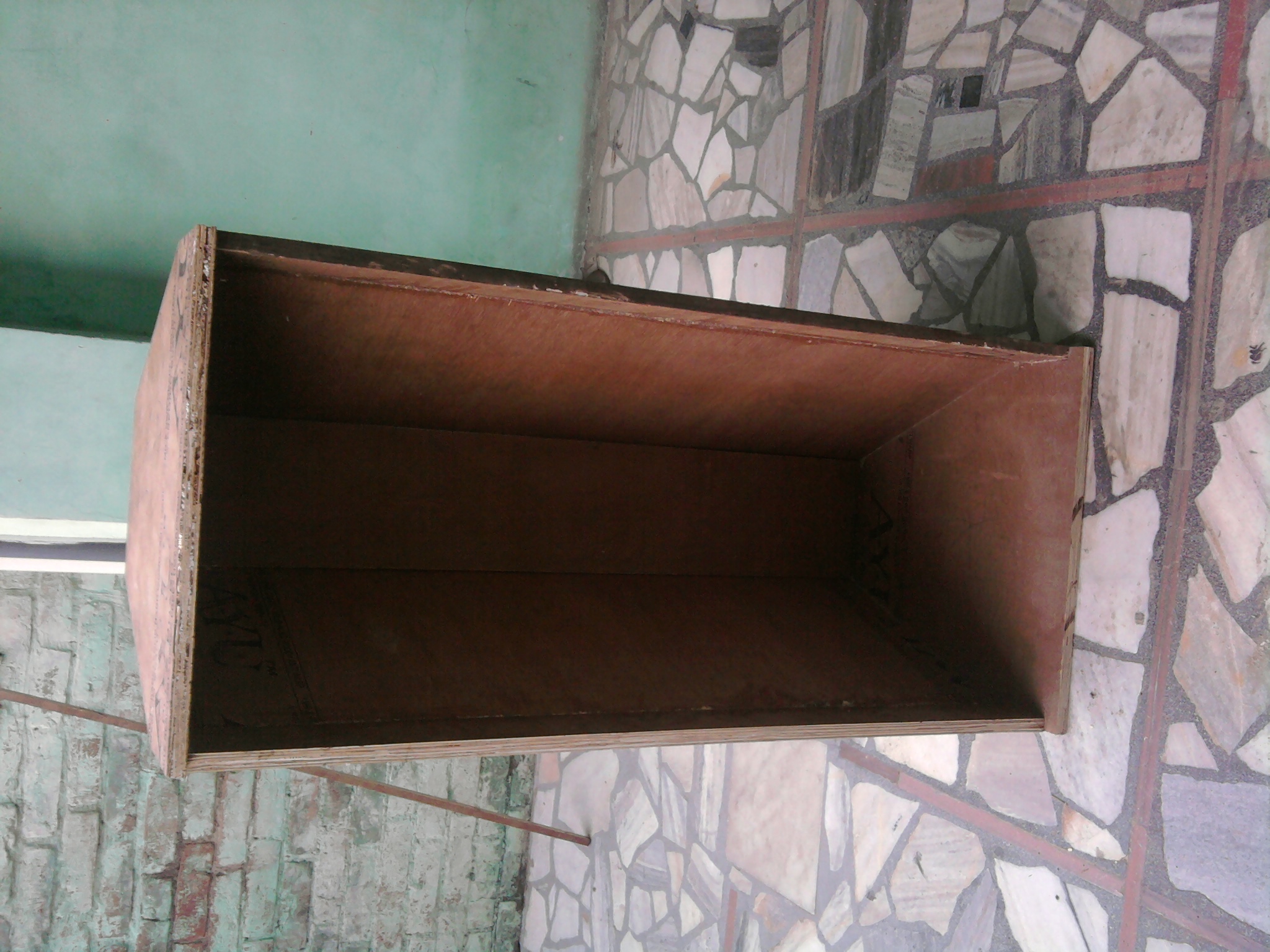

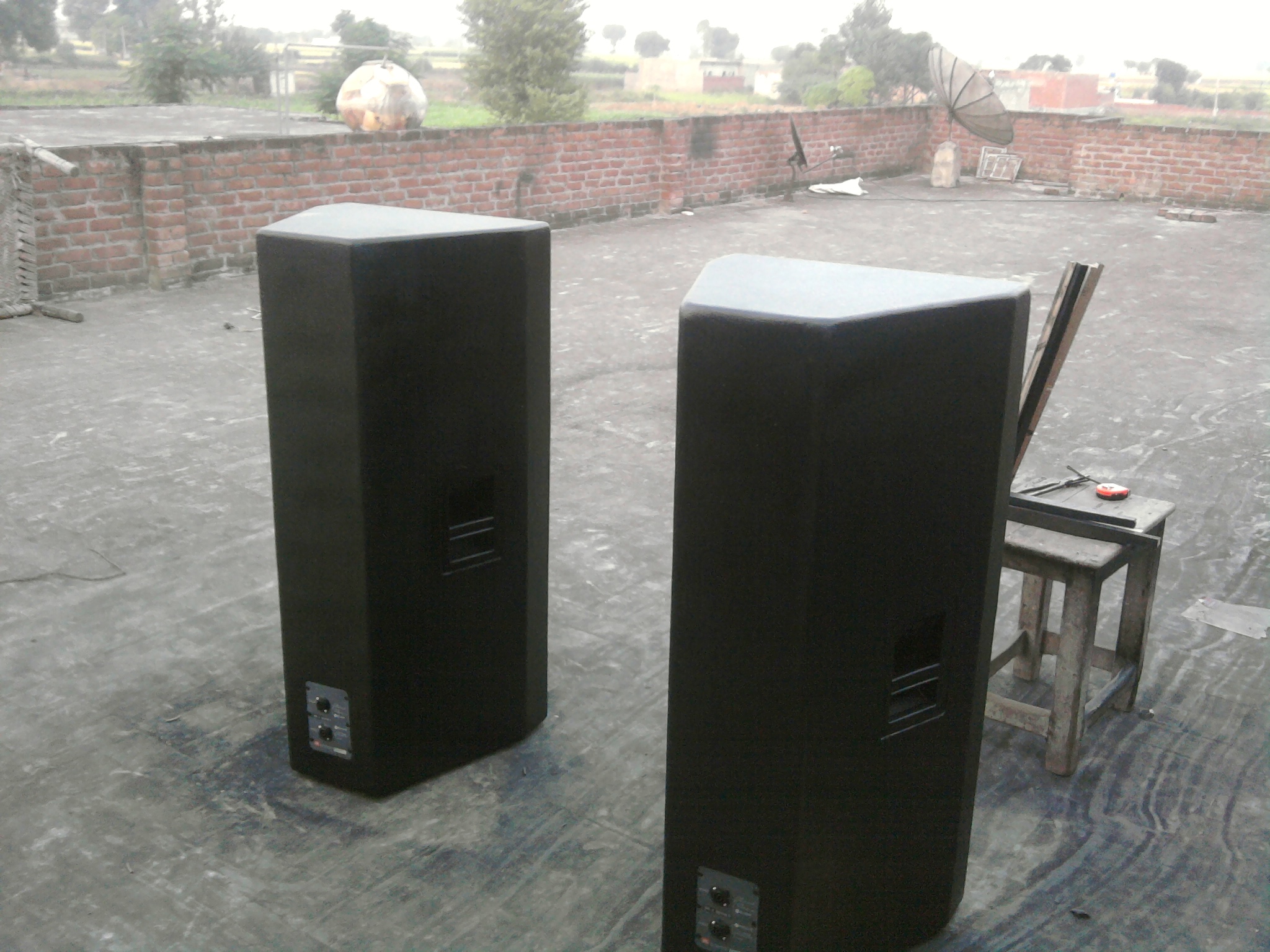

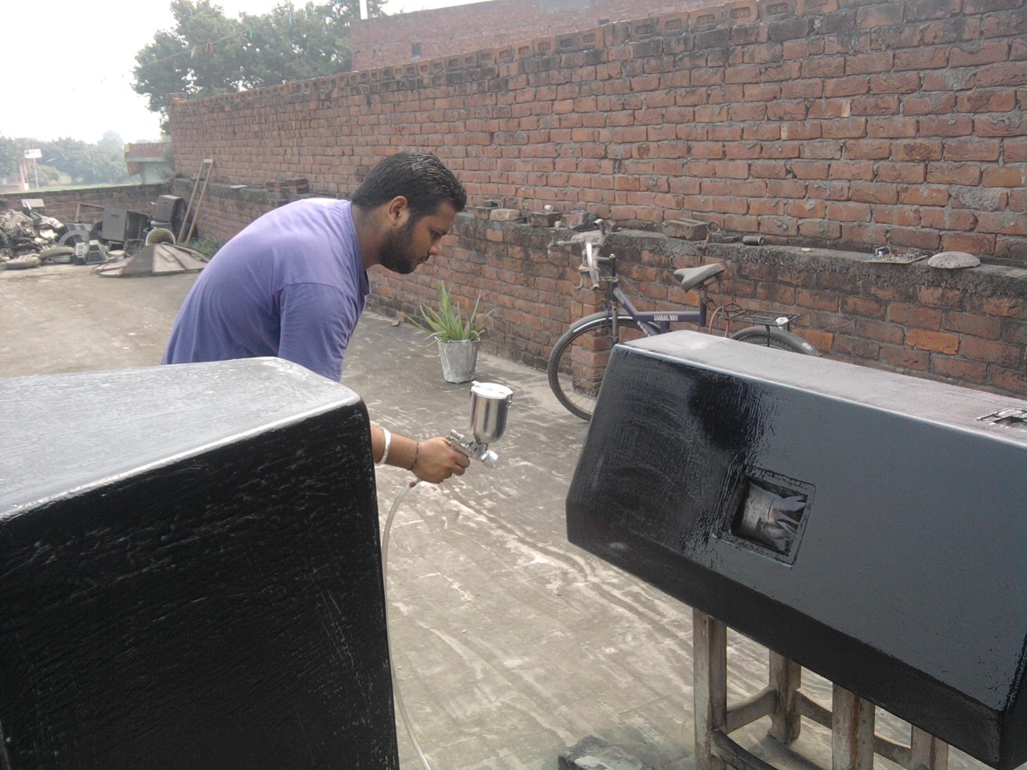

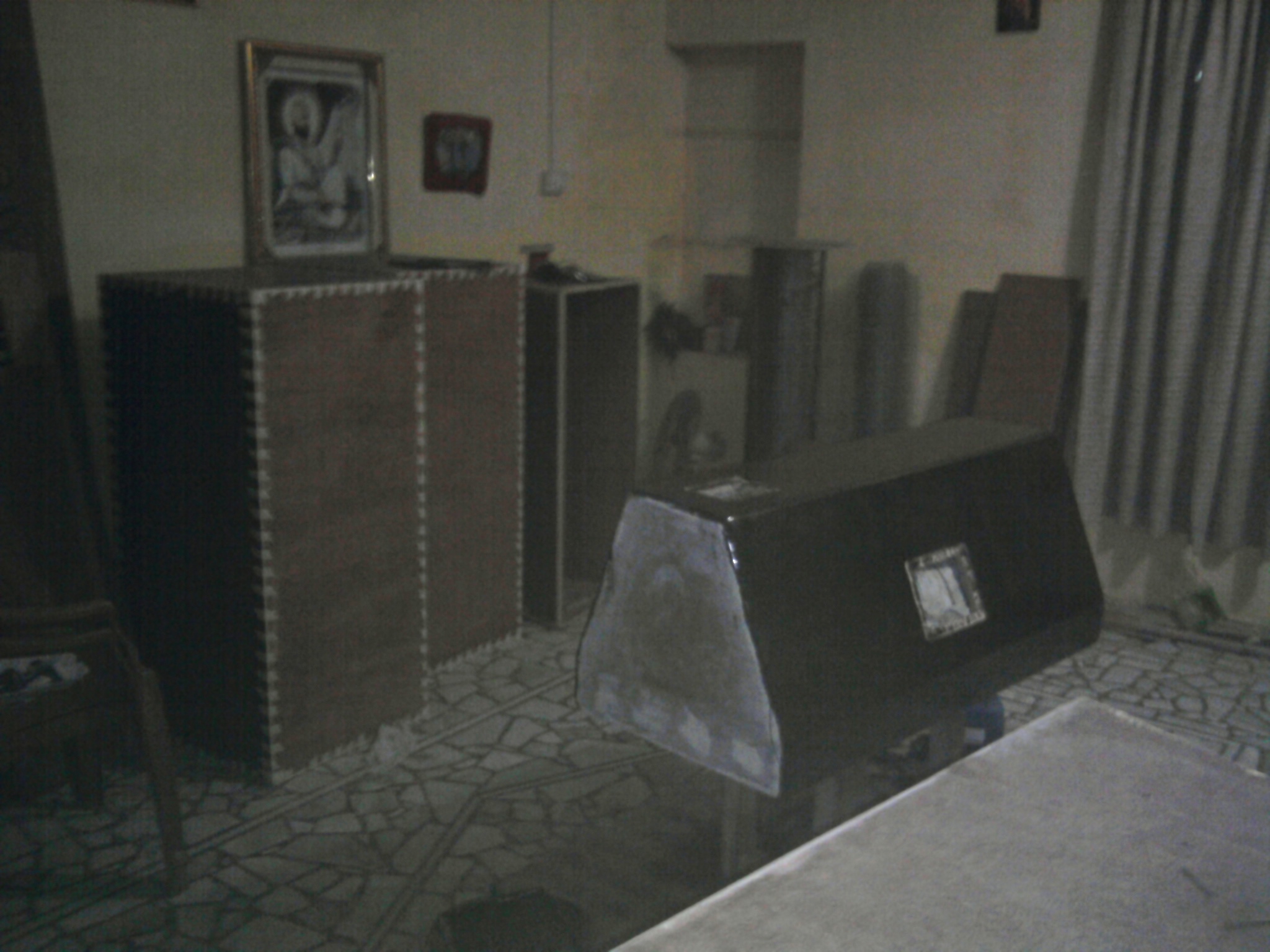

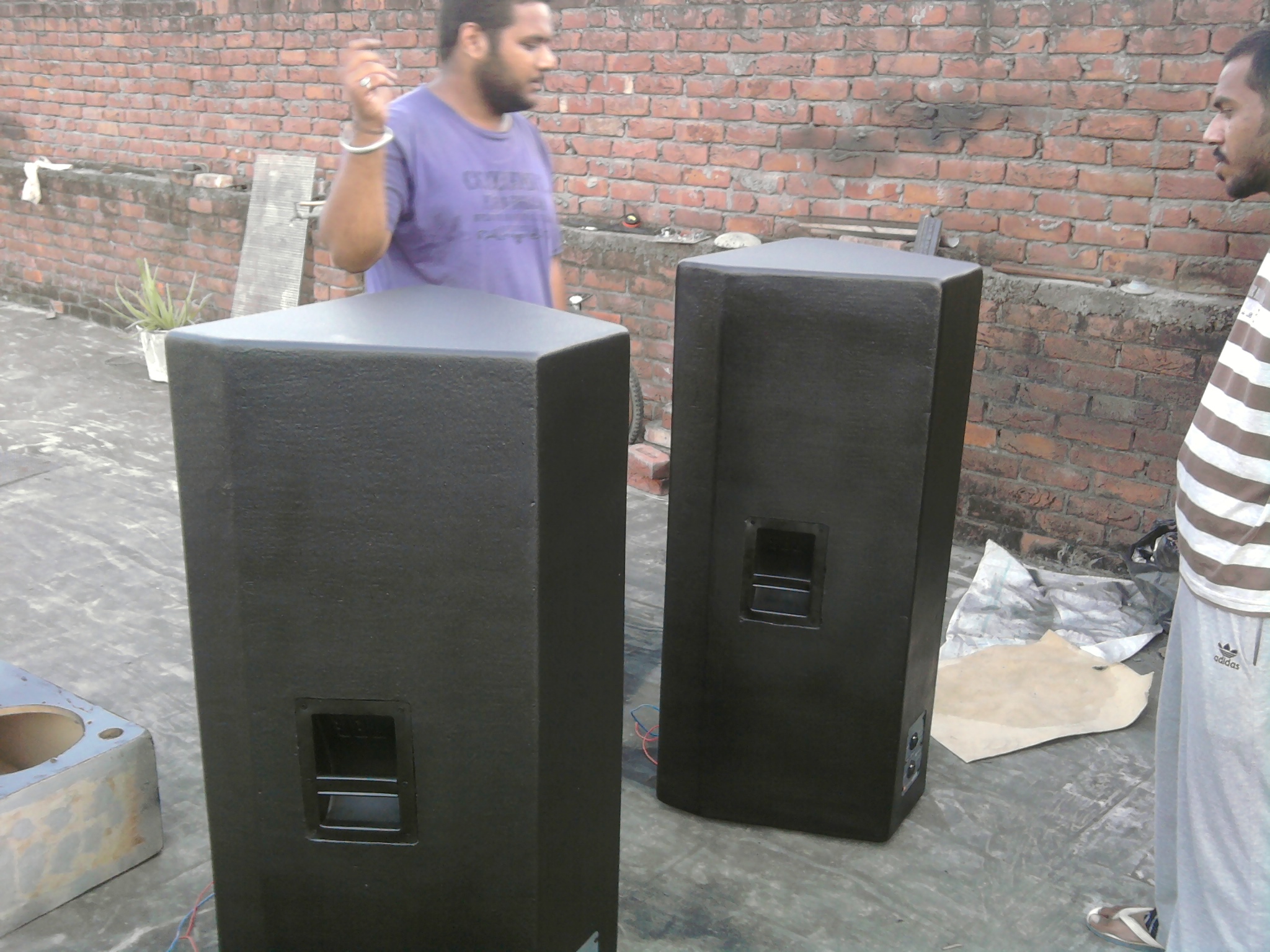

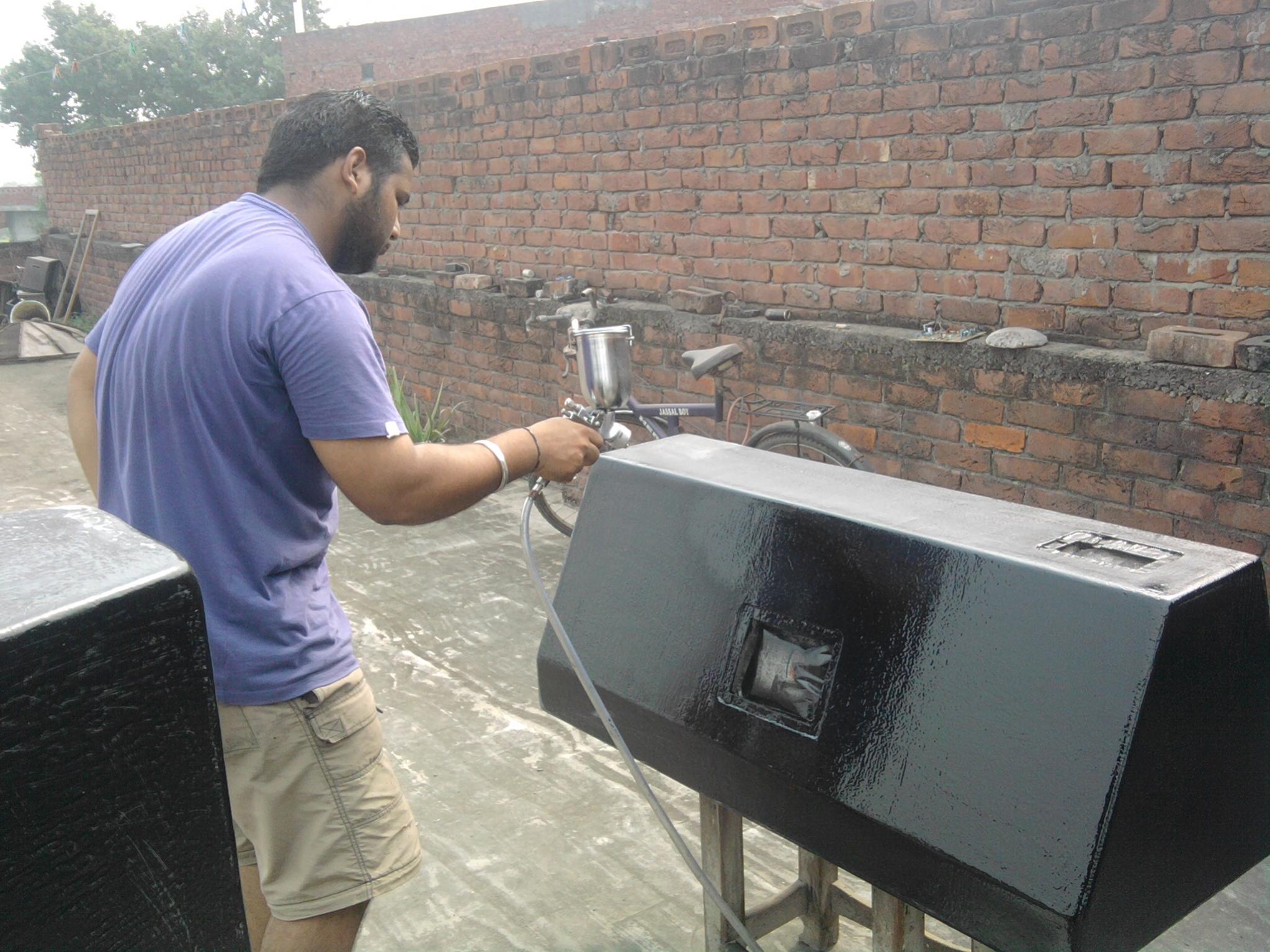

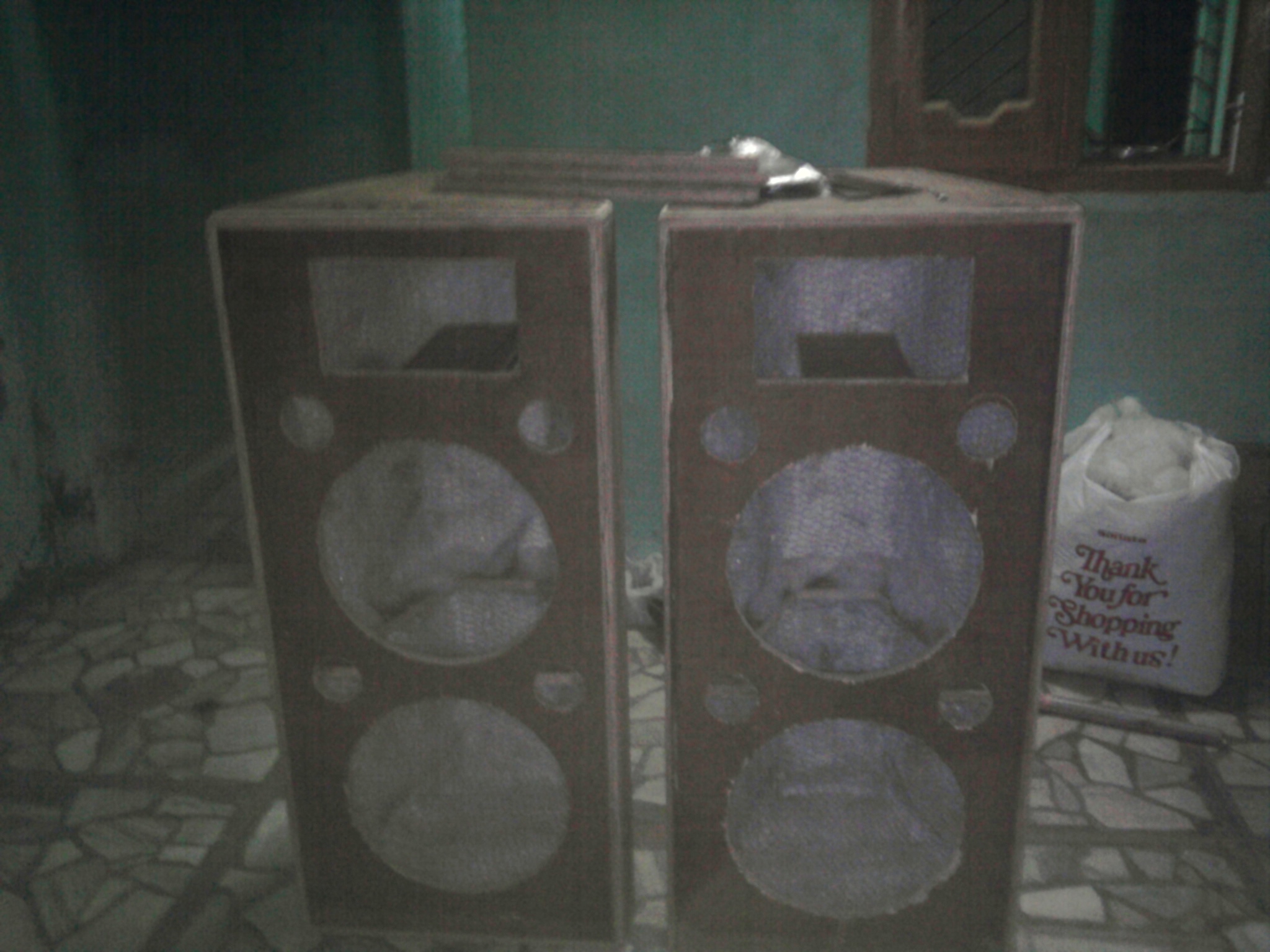

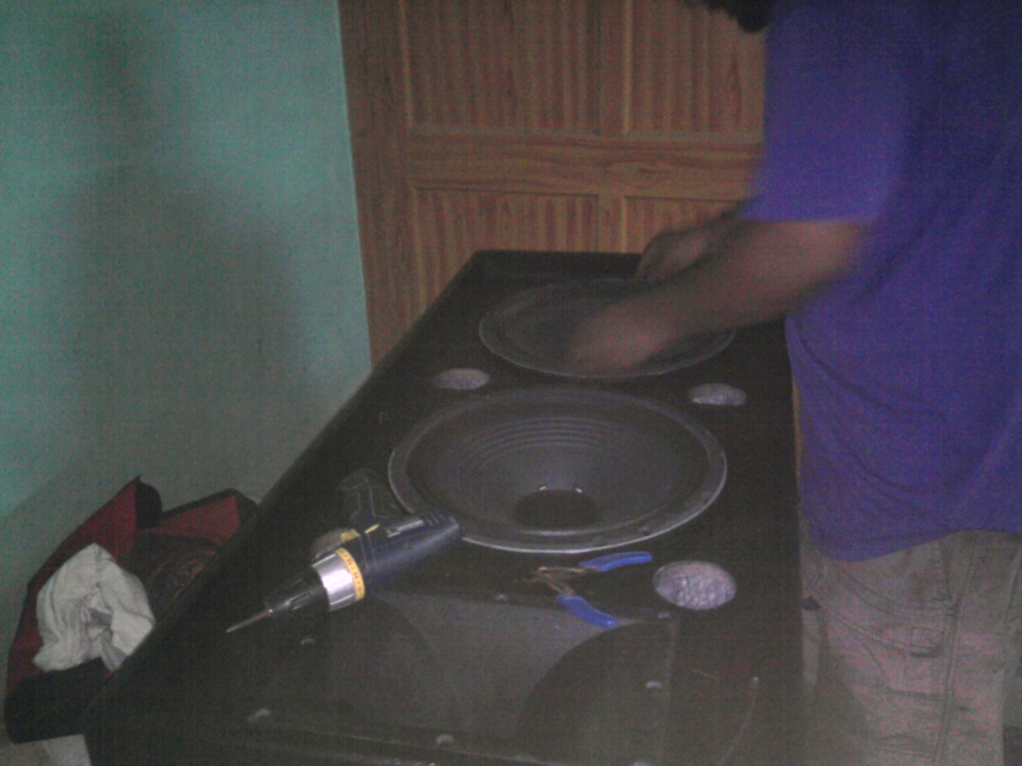

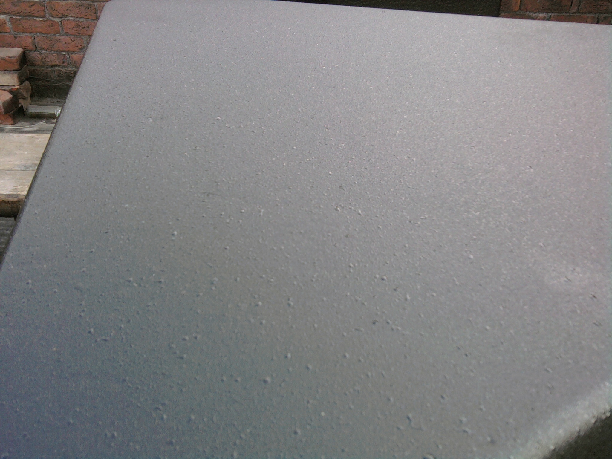

makeing srx clone....
