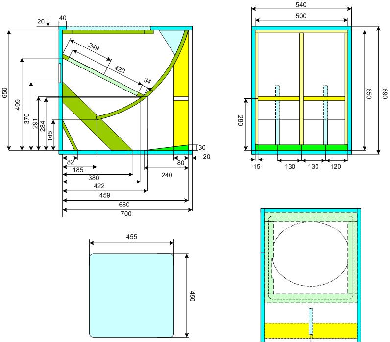

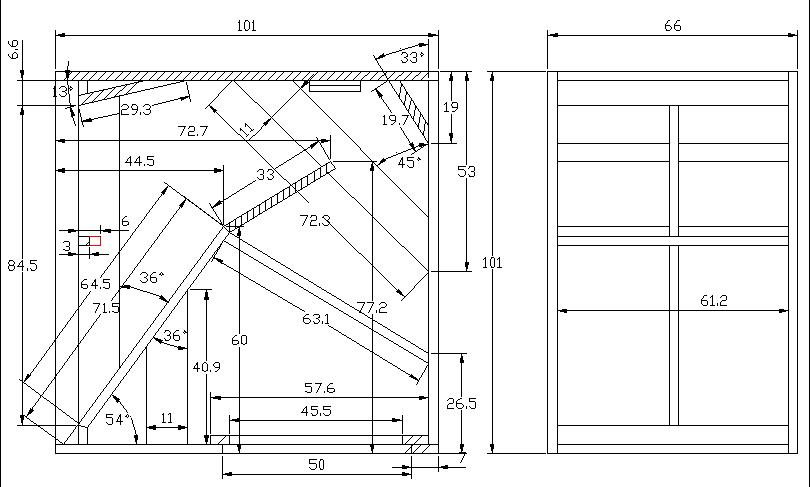

sir jojo,
this is for 21'' plan
how about for18'',can you share plans?
and does the original v. driver use 2 x 21'',and 2 x 18''
is this a modified ver. using 1 x 18'',or the 1 x 21''🙂
Actually this a TSW24...this for 24" driver..
the below are different version of TSW118...
