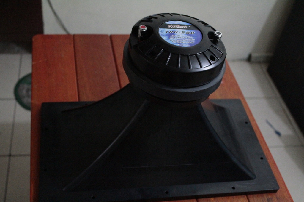

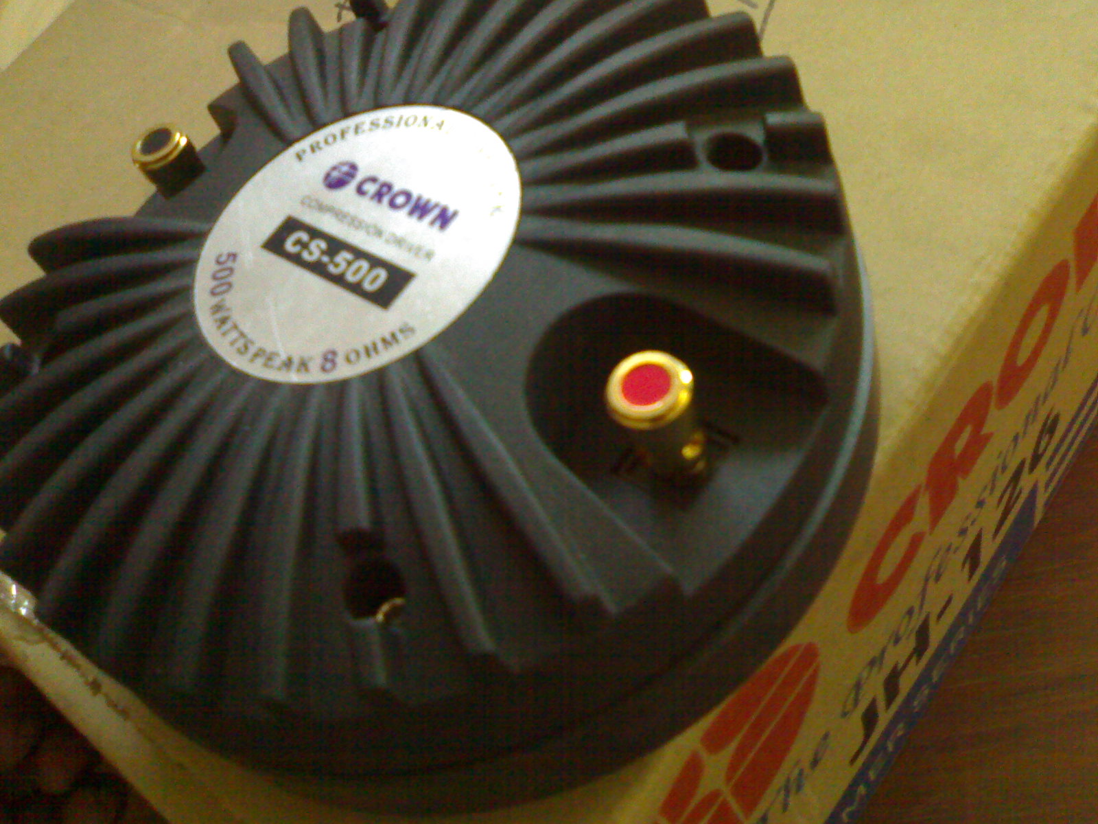

TDU-500 versus CS-500
diyers,
which is more reliable with these drivers TDU-500 versus CS-500? can you differentiate according to performance mga sirs? i was force to buy this CS-500 due to out of stock of the TDU-500 in Raon. "sayang pamasahe" your opinion please,..
diyers,

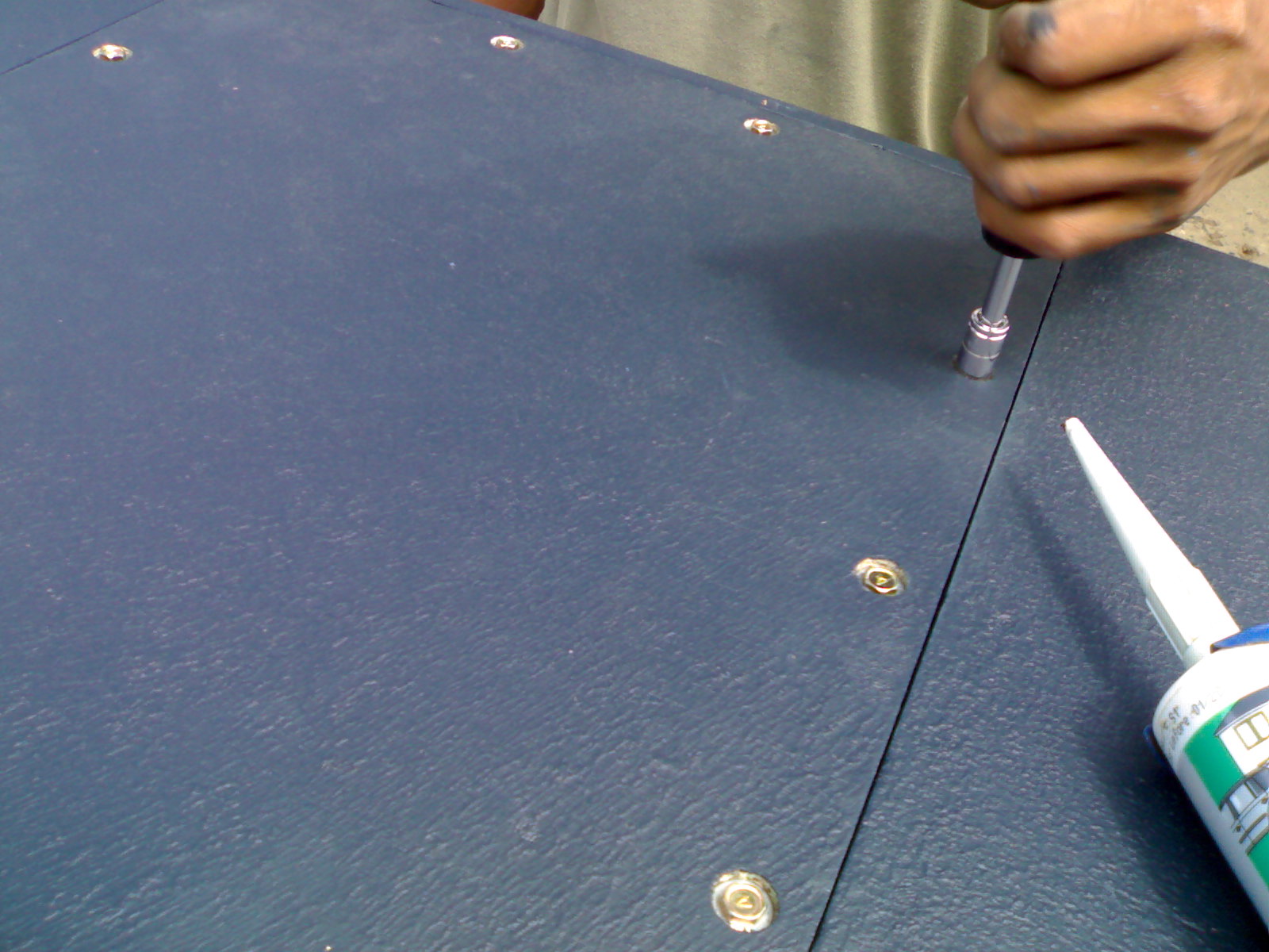

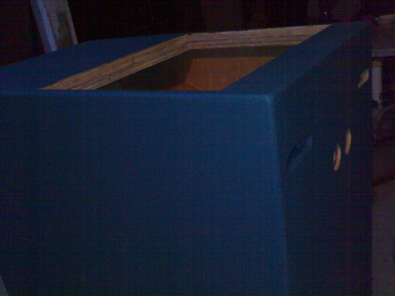

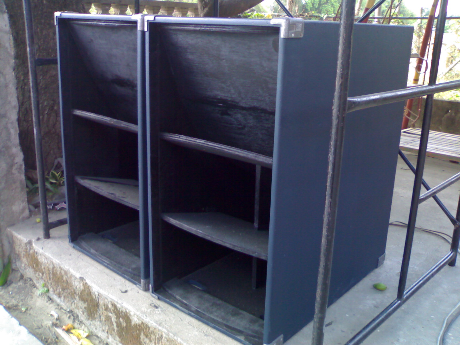

WSX project
here's my project, only first coating inside, black elastomeric paint is not available so i just used SR-202 Delft Blue. . and i cannot fine store to buy the metal grill. . .
whew. . . wish i could post pictures to
mga DIY speaker cabinet users/builders post your pic here
thanks to sir dj_jojo_md. . . Mabuhay!!
what kind of driver did you used?

nice build sir volmax, maybe you are the first wsx user in your place to build one, how much did it cost building 1 pair? how much is your comp drivers? have u tested them side by side? which is better between them?
thanks.

My TDU 500 is 1,600 since TDU was not available, they give it to me on the same price with the CS 500. . . i haven't installed yet the CS500 but my TDU sounds great to me. i'll be cmparing them when i have time, i've got setups still... i spend 9k in building 1pair of my WSX box only. . . luckily i'm the first one who have this wsx box in our place. . .
i used the PRO 1800 PA by crown. . . at first i tried to used the TNT double magnet alumdiecast but it cant carry the pressure cause by the throat design, it makes a prrrt! prrrt! sound. trying another unit of the same TNT same thing happens. so i won't suggest using TNT for sealed boxes. hopefully i could place JH1860 in it. . God bless!
