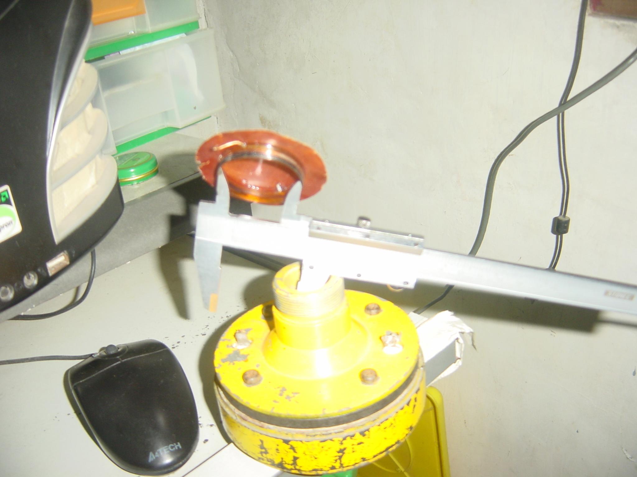

sir jojo,
please help me
i'm so tired of buying and replacing a driver unit voice coil,
it is a crown du-200-pro-ht,currently i'm only using hi pass filter,many times this happen burned voice coil.
please help me with a better way,a two way passive cross over for clone SRX715 box a crown 1530 pa and a crown du-200-pro-ht

sir jo
what would be the right capacitance to be series with my tdu500 konzert i just used 4.7uf and resistor. but it sound so thin. pls help
sir jo
if your using the original supplied 900hz horn...you should not have a problem.
maybe you have some issue about comb filtering...time-alignment of the hi to lo drivers.
Show us some picture of your speaker box with drivers, its really hard to tell...how many do you stack them when in use?

sir jo,
regarding my crown du 200,
when i buy voice coil replacement and check i found almost 19ohm
is this normal in most replacement they sell (solid electronics)deeco not available
the specs i gave before was 8ohm,hope you consider this one.
sir jo,
Sir...they may have given you by mistake a 16Ω VC use for a Siren Bullhorn...you have to return it back and ask for a 8Ω VC...physically they look the same due to the same phenolic VC type.
