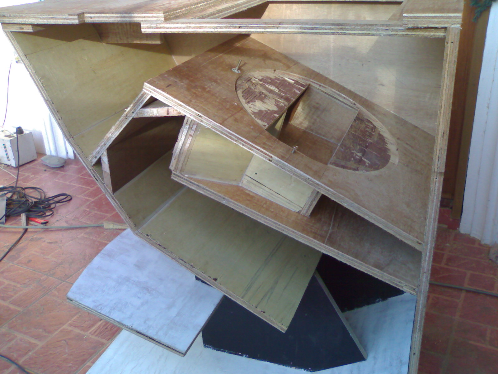

Sir, I have just built a WSX box base in your post at diyaudio. i have a problem about distorted flocking sound which is i think it's due to the rectangular hole in the mounting speaker area. the force of the cone is trapped which causes prrrk! prrk! prrk! sound. what is wrong in it? sir jojo please help . .please help from anybody

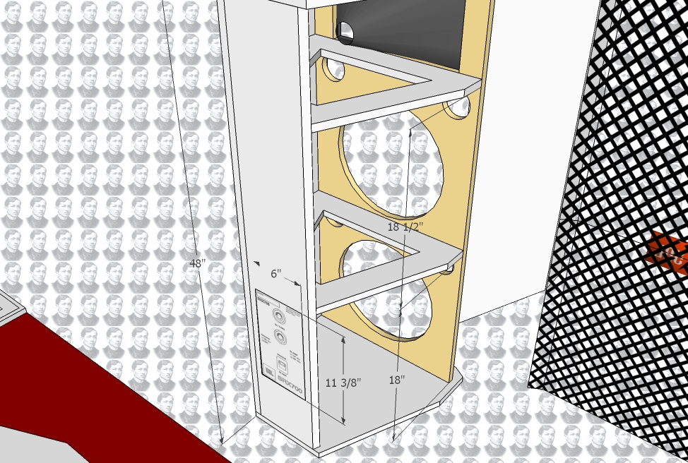

mga DIY speaker cabinet users/builders post your pic here
1. You need to check if you drivers cone is not touching the module or else you need to place a 1/8" sitting pad to increase the height allowance.
2. make sure that you dont have any air leak...remember that this is a "sealed" horn loaded box...if you lose the vacuum the driver will over excursion to its mechanical limit.
3. make sure that all joints are firmly glued at screw together...if not...when the cab starts to pressurize this could cause unnecessary sound.
4. be sure to screw all complete 8 holes of the driver and properly tighten.
Have a nice day,
jojo
1. = no it doesn't touch the module, anyway 18mm marine plywood has 5 ply, i remove 2 ply in the rebate of speaker displacement, is this ok or take out 1 more sir?
2. = over excursion to its mechanical limit? this probably my problem. . . i tried to change the driver from TnT to Crown and it was good, suddenly after 2mins of playing the music @ normal volume, a krrrt! krrrt! sounds came out and the sounds got off. i checked out the driver, it's been stack, the cone doesn't play anymore. i cant smell any burnout from it. i'll be checking it 2morow what really is.
(2yr old tnt sounds krrrt!, krrrt! along the way, compare to 11 yrs crown)

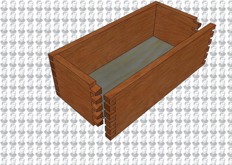

sir kindly check my attached thumbnails, is that what you call DOVE TAIL? that's the way i make my boxes. . .

1. rebate is ok...just add 1/8" (lawanit will do) sitting pad/spacer to give more allowance for the driver excursion.
To seal the cover...use a cut-off strip of rubber foam...you can buy this from any Shoemaker Store that sell all kinds of rubber materials...to adhere use a contact cement or double adhesive tape.

This is how dovetail joint are done.

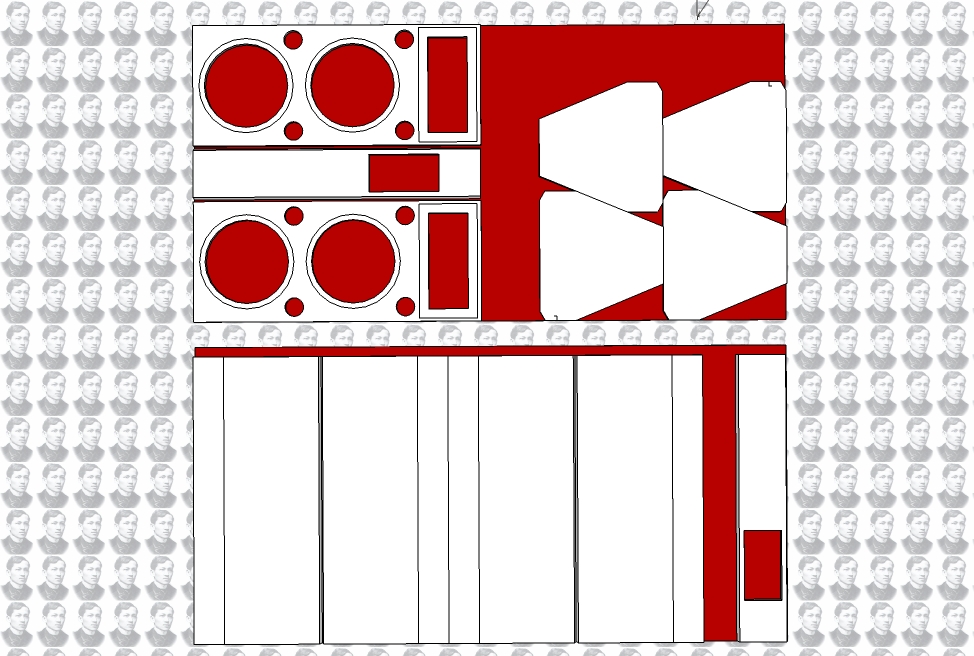

Here you go...

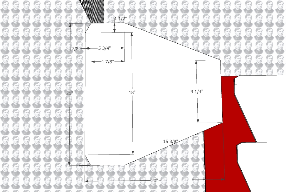

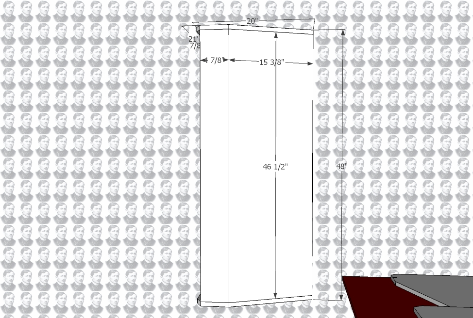

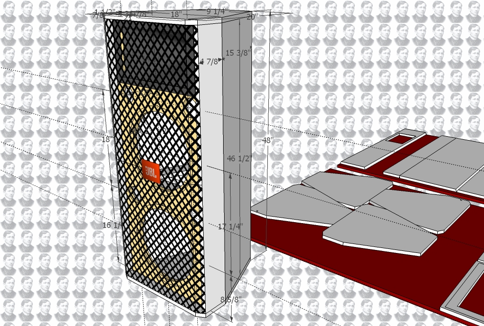

Do you have measurement for 15 inches speaker with this design?
That is 2X15"...Sir.

wow.. thank you very much.. jbl SRX725... clone like X-line, Kevler and LIVE..
