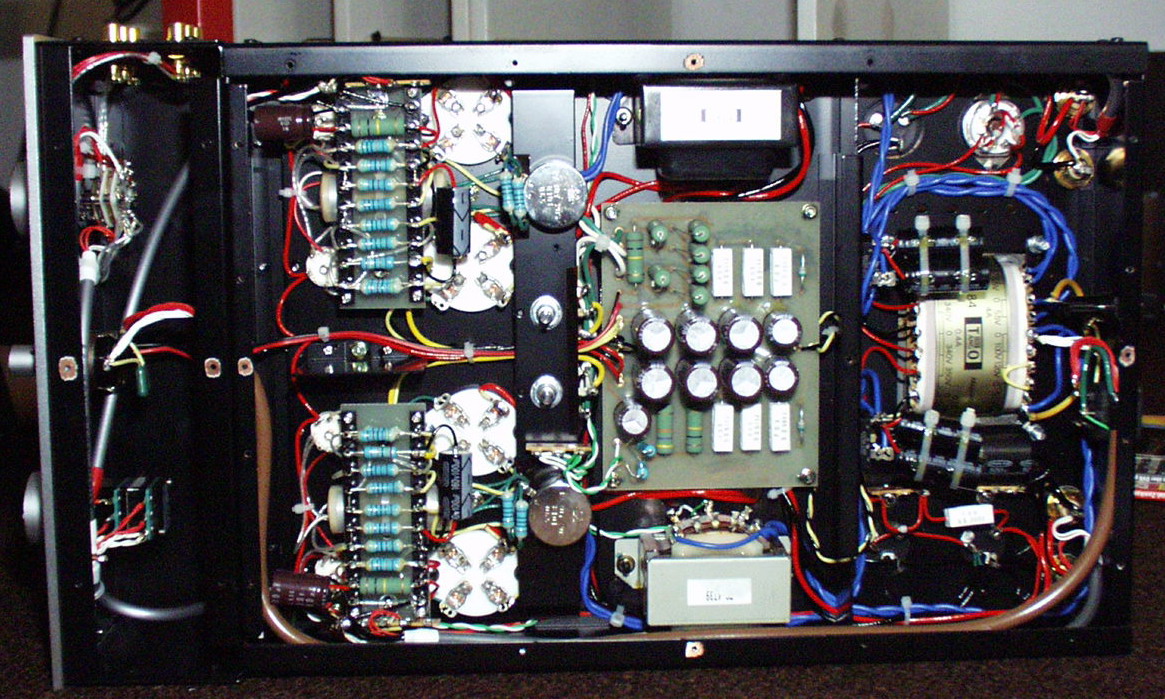

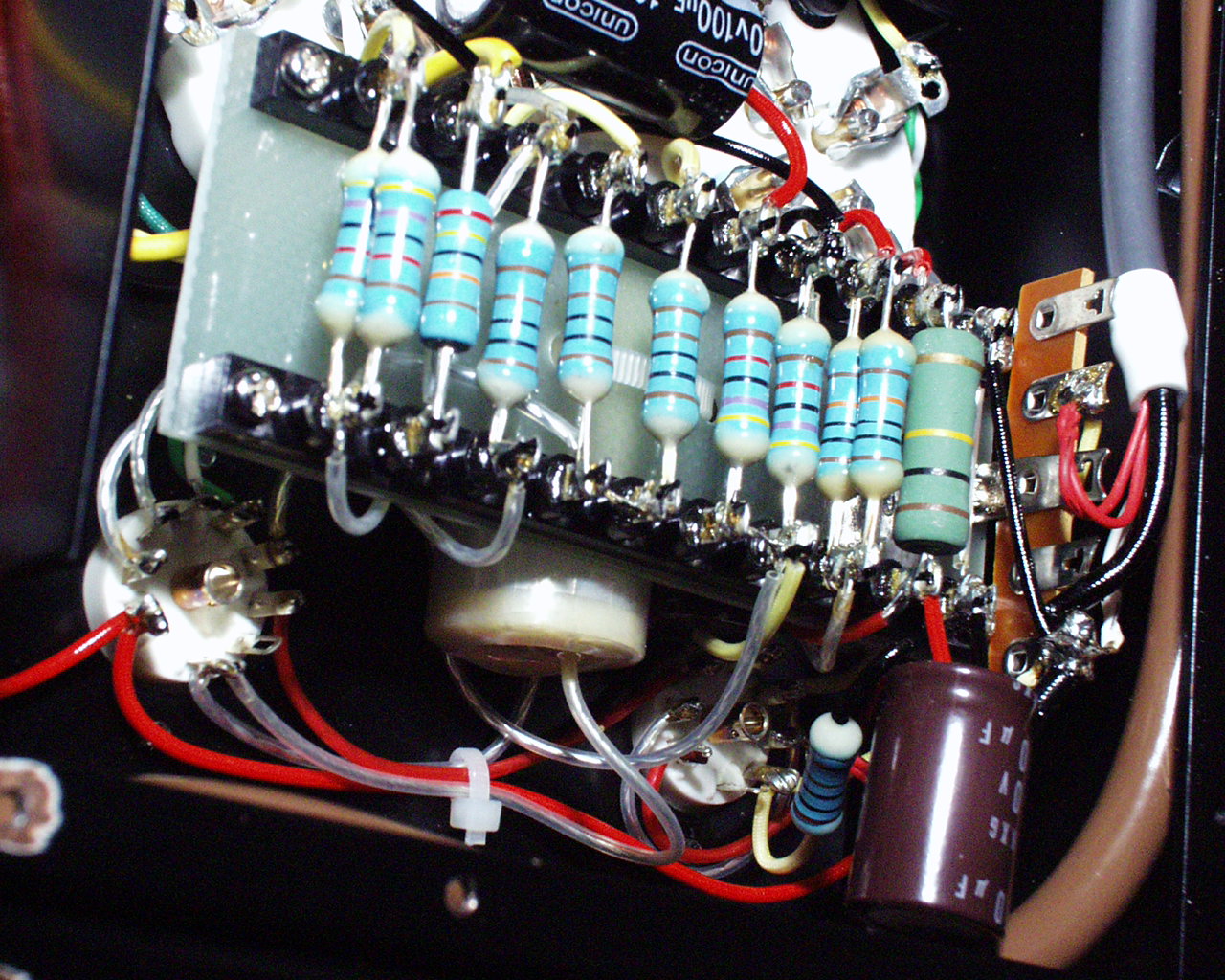

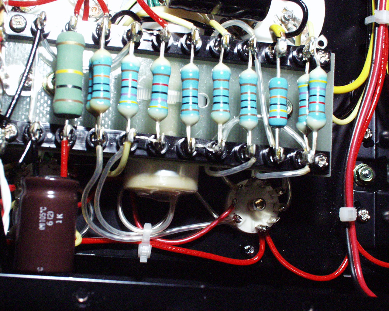

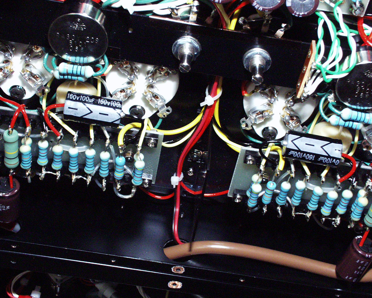

Sorry for the delay (there is a 9-hour difference between your location and mine).The Kegon pics you asked for:
I cannot vouch that the pictured Kegon was 100% original or some things were modified in it...it's a long time since I had it on my bench and I just cannot remember every detail about it.

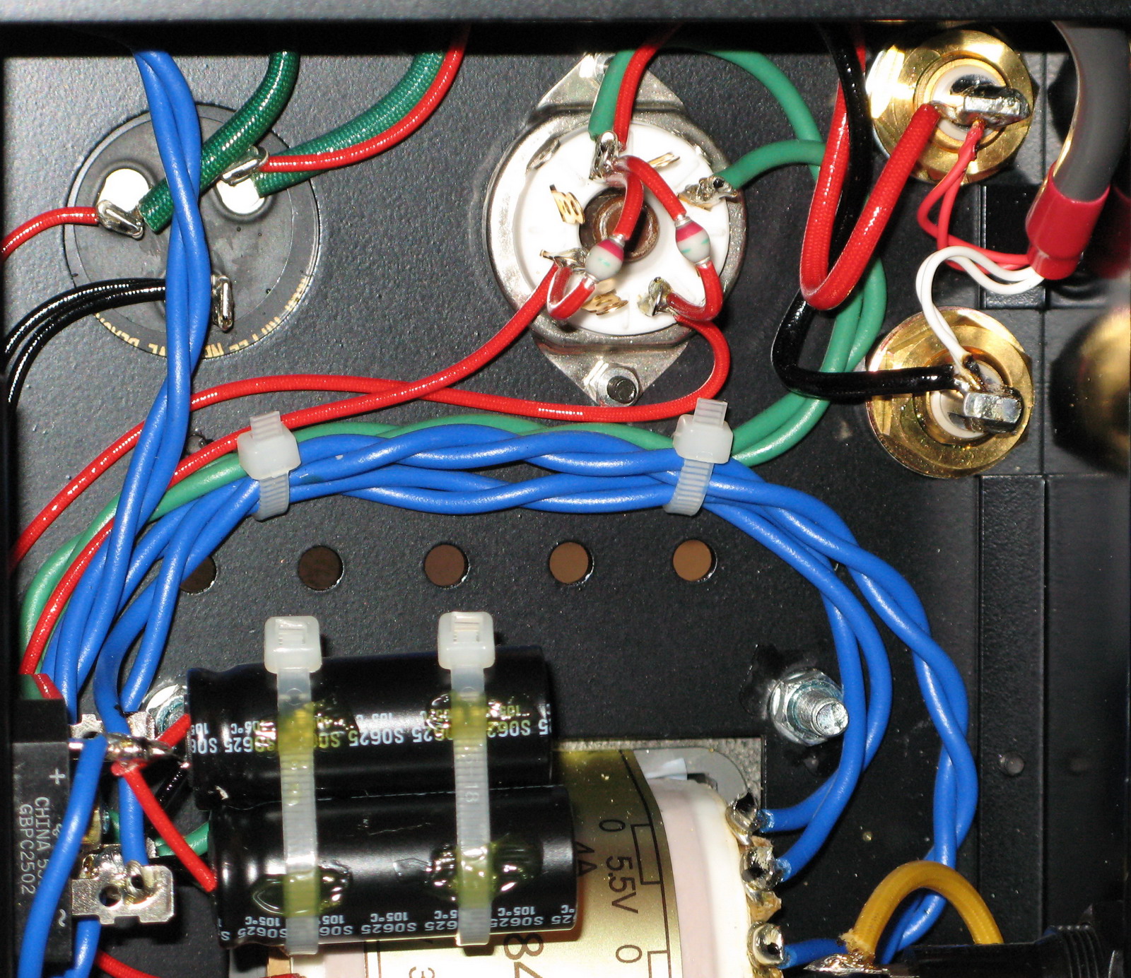

You made me curious (OP,sorry for the digressions!) about this.Like in the picture,I always routed the HT wires as independent (not twisted or touching,double-isolated) because I always had a fear for the rather large potential between the two (more than 800V sometimes) and not very confident in the PVC/whatever isolation to withstand a possible accident.wiring is not so good, the ht wires going to the rectifier should have been twisted, not only to make it look good but for rfi suppression as well...
Otherwise,the RFI supression you mentioned...am I wrong if I trust the rather generous ammount of uF's and H's following the rectifier?
I'd also say that twisting the HV wires serves for hum suppression rather than RFI, as does twisting any AC wiring.

Looks like you missed my point.I wan't asking about AC lines in general (eg.AC mains,AC filament wiring wich I'm familiar with) but of this specific given situation - AC wires between XFMR and rectifier valve.the late AndrewT keeps a close eye on ac lines not twisted.....it is a good practice in any book...i have not encountered problem because of twisted wire pairs...

i criticized your drawing for not twisting wire pairs, the main reason for twisting is so that the loop area between parallel wires are minimized, it is not so hard to see, your parallel wires from the traffo to the rectifier has the biggest loop area, twisting them minimizes the loop area, did you get what i was driving at...? any field created is effectively cancelled due to the twisting...
