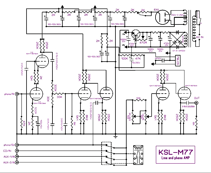

If I understand the schematic, and assuming that the schematic is correct, the first tube runs at 140Vp-k at ~500uA per section and about the same for the DC coupled CF. Pd ~0.07W - tubes would last a long time!
Looks kind of standard and un-inspiring, yet so highly reviewed even at 30k or so (with phono).
In house caps and resistors, a 6X4 in parallel with SS diodes, some electro B supply caps. I might have to build this thing.. can it be THAT easy?

Like you say, un-inspiring, and I agree - Looks like the stock version of the $99 bottlehead foreplay lineamp from 10 years ago with a different tube.
Question is: how to turn a sows ear into a silk purse?.. hocus pocus cant be the answer. The operating points are all there.

Where do you see the PSU schematic? I heard that they use only a couple RC filtering cells after 6X4 rectifier (no SS diodes) and first cap into 6x4 is 100uf. Owners are changing rectifier tube every few months . I wonder why ;?)

In the pic at the linked site you can see the SS diodes across the 6X4. Also, google search confirms.
100uf after 6X4 may not be so critical with such low current demands, even if it was used without the SS bypass. There was some comments about the M7 5687 version about this floating around a couple years back.
Kind of odd that they need to replace the 6X4, you could pull it completely and the stage would still function :)

So I got to thinking. Why do they want 12.6V? The 12AY7's. And why are the 12AY7s even in he circuit? WAYYY too much gain for what we got going on here.
Then I thought some more and came to conclusion that replacing ALL of the 12AY7s with 12AU7s may be just the thing to do.
Advantages:
1) The circuit is not going to have to put up with a ridiculous amount of gain.
2) The filament winding on the power transformer can be 6.3V
3) in eliminating the 12.6V filament supply, much of the noise is eliminated too, and
4) the transformer will be much easier found.
But what will need to be altered to accommodate the 12AU7's? Someone was saying that the inly real required change would be to putt all of the 5K1 resistors in the cathode circuits.
Here is where I need some help... I need to know exactly what needs to be done to the circuit to make all of the 12AU7's happy and feel right at home.

....................Why do they want 12.6V? The 12AY7's.....
12AY7 will run either 6V or 12V. Just like 12AU7, or T, or X.
Here they want the 12V connection because they use DC on the heaters and higher voltage lower current suits available parts much better.
The phono section DOES want a hi-gain tube. Even 12AX7 is not always enough for accurate bass EQ.

Regarding all of the resistors in parallel - are they for creating the correct resistance as the circuit intends..
or
Are they for the support of different types of tubes? Perhaps the circuit as shown is for 12AY7s but if one were to not include the 5K1 resistors, those sockets could take 12AU7s?
Also does anyone know the exact Marantz circuit this preamp was copied from?

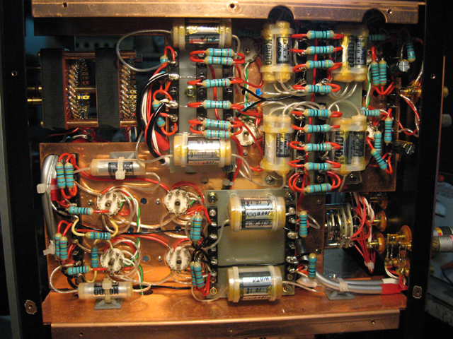

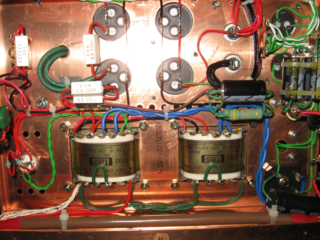

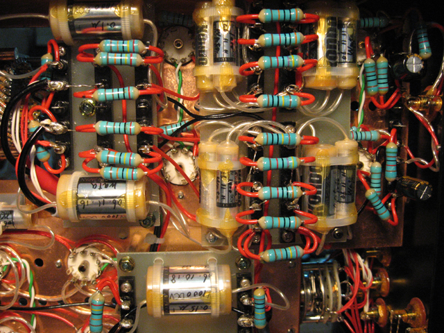

I found these images archived from the web-address in Viet Nam.
Resistor values in the circuit traced schematic appear match the photographs.
Note SS diode bypasses across the 6X4 rectifier.
