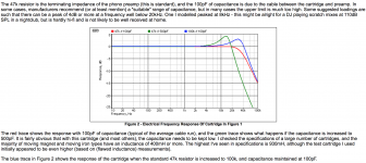

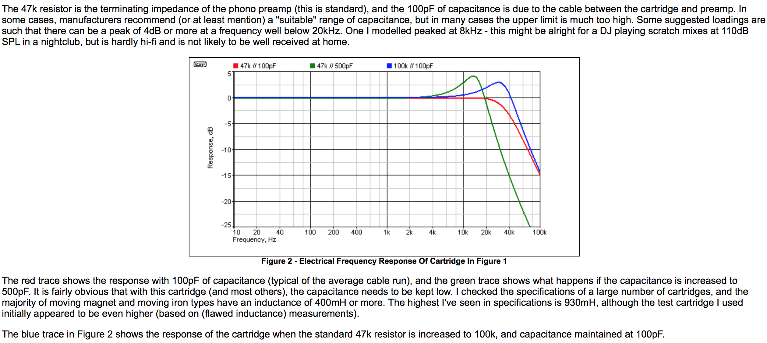

Cartridges may have a self resonance like an output transformer. For example, there may be a peak above 10k just before it rolls off unless it is loaded down.
OK-- I think I get what you mean. So, I've to a Denon DL-103R (moving coil) and I have a 100R resistor in parallel with the output. I've changed the parallel load quite a bit to see if that makes a difference with the sibilance and no dice.
Is this what you're referring to?
It's been a while since I've done it so I'm not sure how much I remember. I also used to use MM cartidges so maybe this doesn't apply in the same way.
What I found is that loading with the standard 47k can leave a peak. When a capacitor was also used (adjusting for cable capacitance) the response I ended up with that worked was a couple of dB down at the point where the peak used to be, and the rolloff was then coming from a slightly lower frequency than the cartidge would naturally roll off.
If you use a MC step up transformer, is it possible this will also apply to that transformer?
Yes. I have both a transformer and JFET step up and I have applied a resistive load to both. I wonder if messing with parallel capacitance could change the peak frequency. Looks like additional capacitance would move the peak up in the frequency range?
