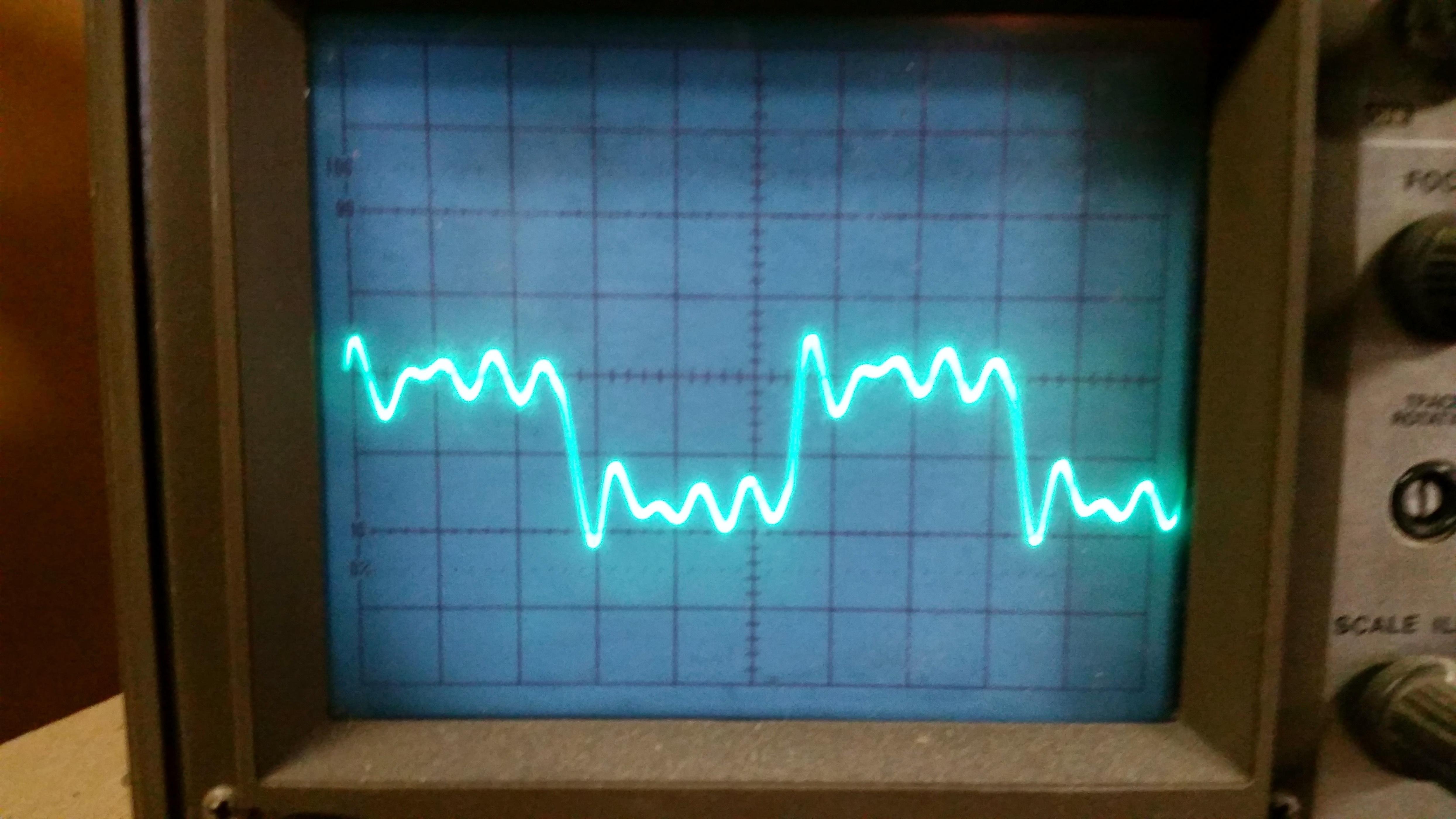

OK-- headed out to the shed to do some testing. I haven't fired up the o'scope in a long time, but I'm thinking I'll try the old 10kHz square wave test to see how it performs.
I'll post progress as I go...

Ran a 10kHz square wave through it. Not impressive (see attached).
Maybe a Zobel or some NFB would clean it up?
Advice?
Kofi
Advice?
Kofi
