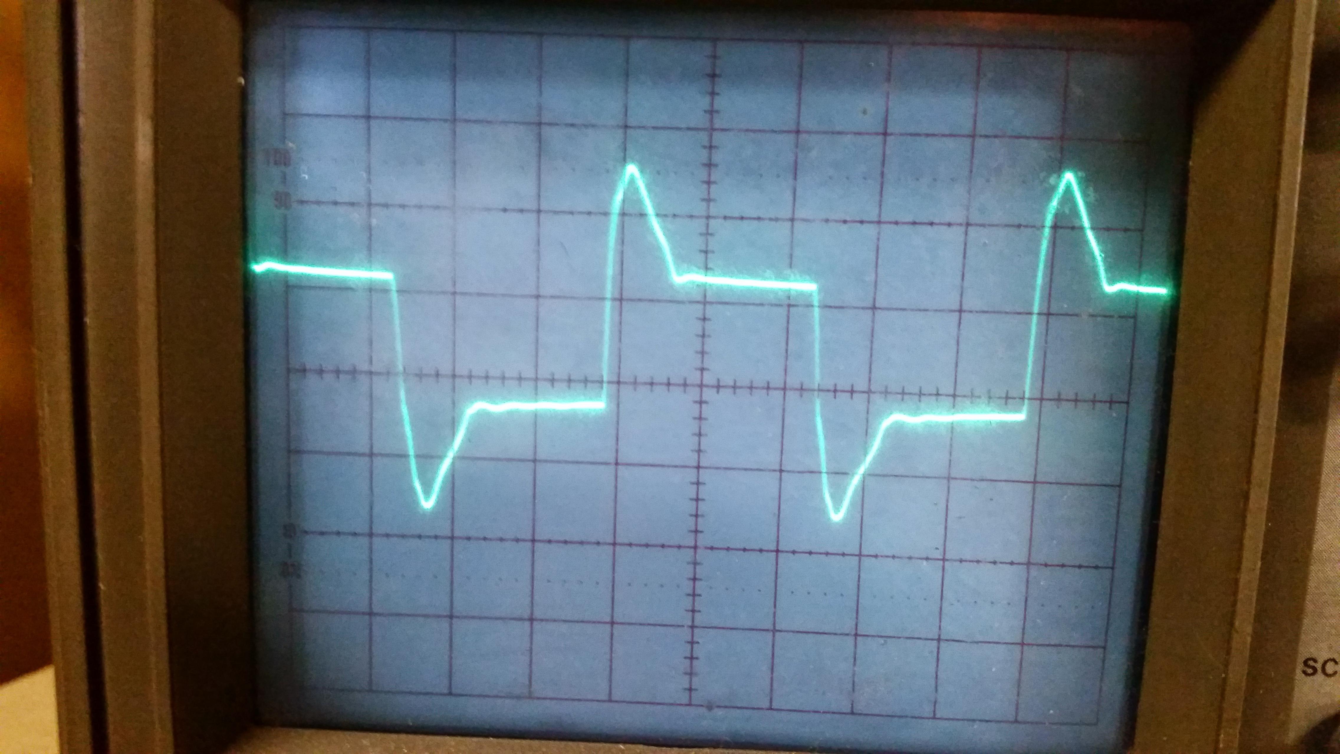

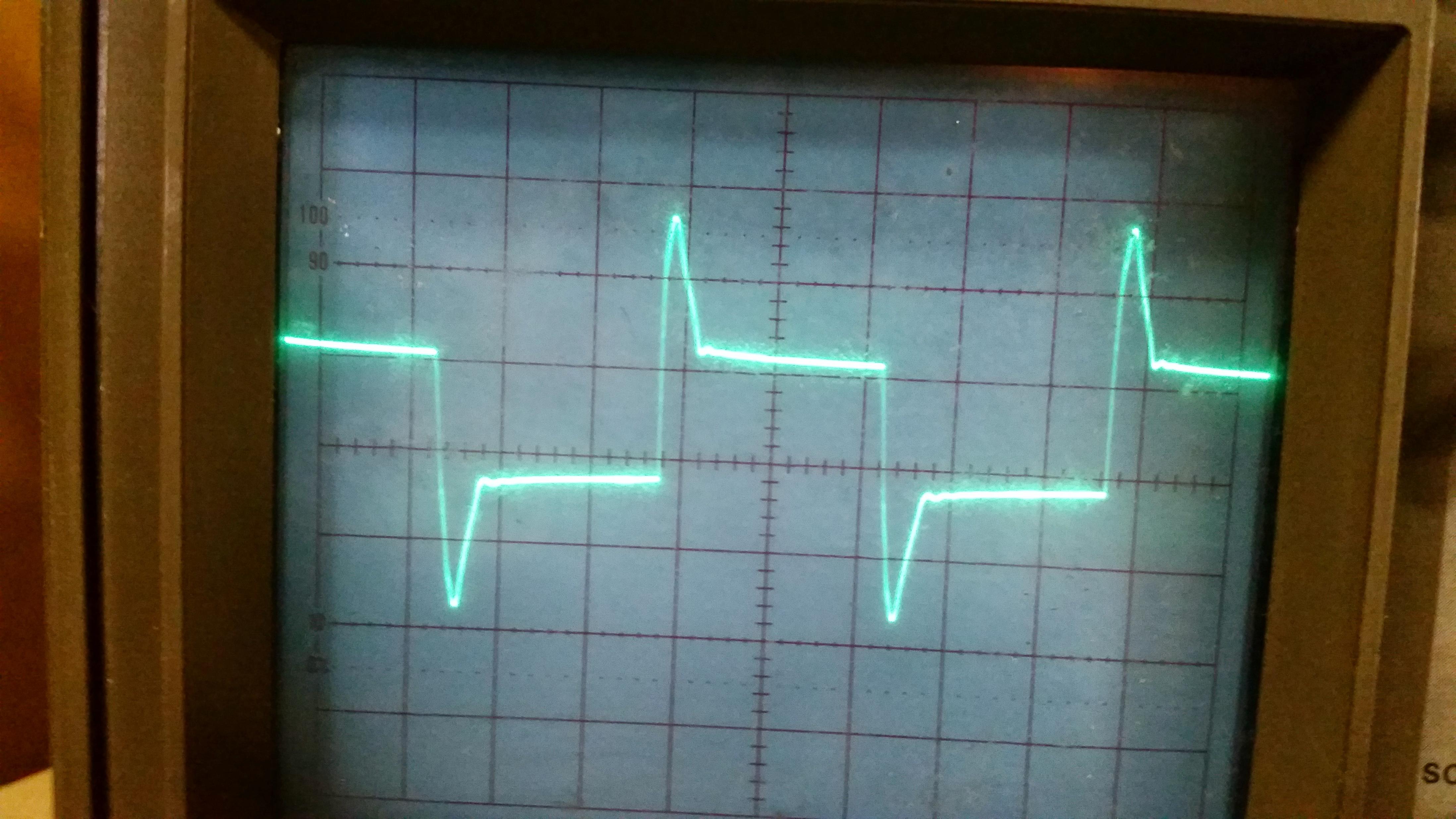

Kofi,
Check the 10kHz square wave at the output tube grids.
What you need to find out is if that underdamped response is a function of the front end or an interaction between power tubes and the output tranny.
If the later then a zobel (conjunctive filter or whatever you want to call it) of series cinnected 1K and say 2.7nF wired between anode and screen connections of the output tranny (1 for each side) would be the next thing to try.
I arrived at these values by the following method:
Raa = 6K6, The primary winding (turns) ratios anode to screen : screen to CT : CT to screen : screen to anode ared 0.3 : 0.2 : 0.2 :0.3 (For 40% U/L).
The zobels go anode to screen tap so that is 0.3 of turns for each side.
Coz impedance ratio is the square of turns ratio then the impedance of the anode to screen sections is 6K6 x (0.3 ^2) = 594 Ohms
For a Zobel you want the resistor to be 1.4 to 2 x that 594 Ohms
i.e. between 831 and 1188 Ohms.
So use 1K
The ringing looks like it is about 60kHz (about 3 rings on each side of the 10kHz square wave).
So 2 x pi x frequency = 377,000 and that = 1/(R x C) Note: R x C is called the Timeconstant
Take 1 on that to give the Timeconstant of = 2.65 x 10^-6 then divide by the R = 1K to get the C (2.7 nF).
If this cures the ringing you can try lower value caps (2n2, 1n5 etc).
Ideally you want to see a slight overshoot on the leading edge with no ringing.

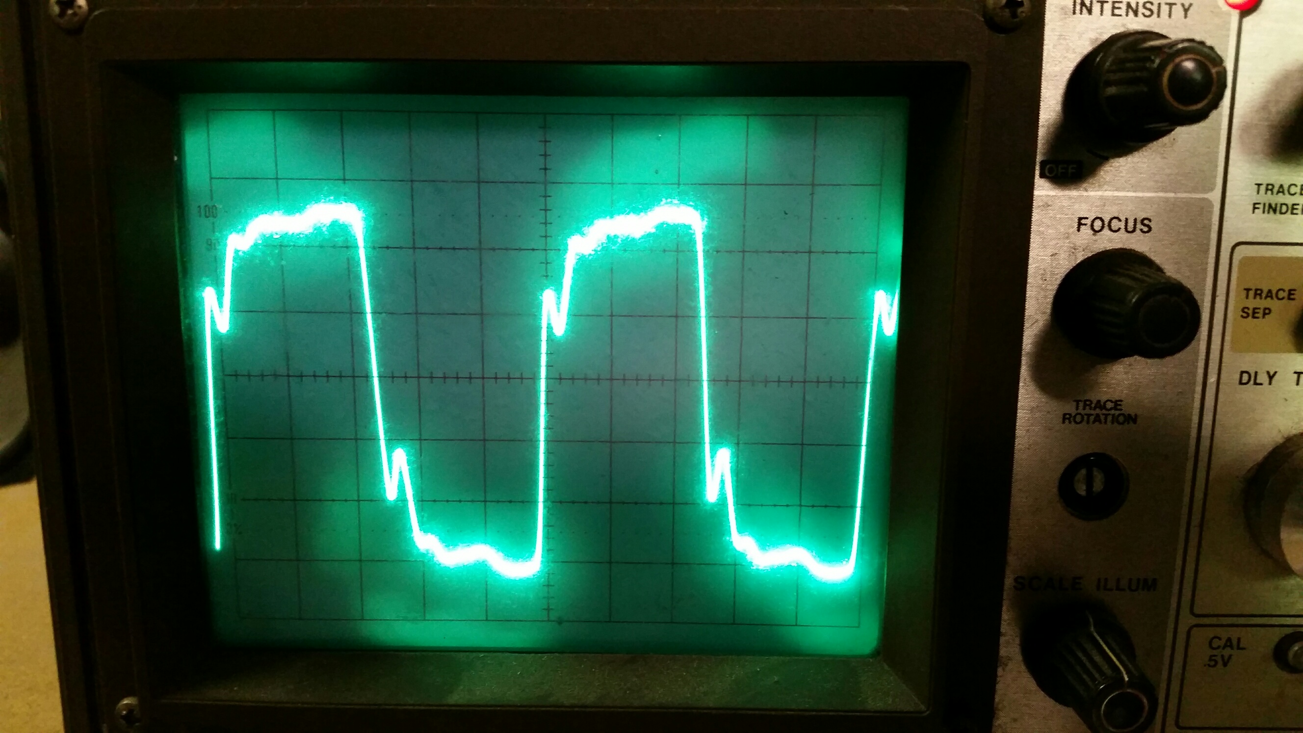

OK-- so, today I went out and pumped a little more voltage through the amp by maxing out the volume from the signal generator and the square wave changed to what you see below.
Could it be that I just didn't have the volume up enough? It looks like there's some 'notch distortion' here at the cutoff point, which I would expect from a push-pull amp without NFB, but also maybe some additional noise that could be cleaned up?
Maybe some NFB is warranted here?

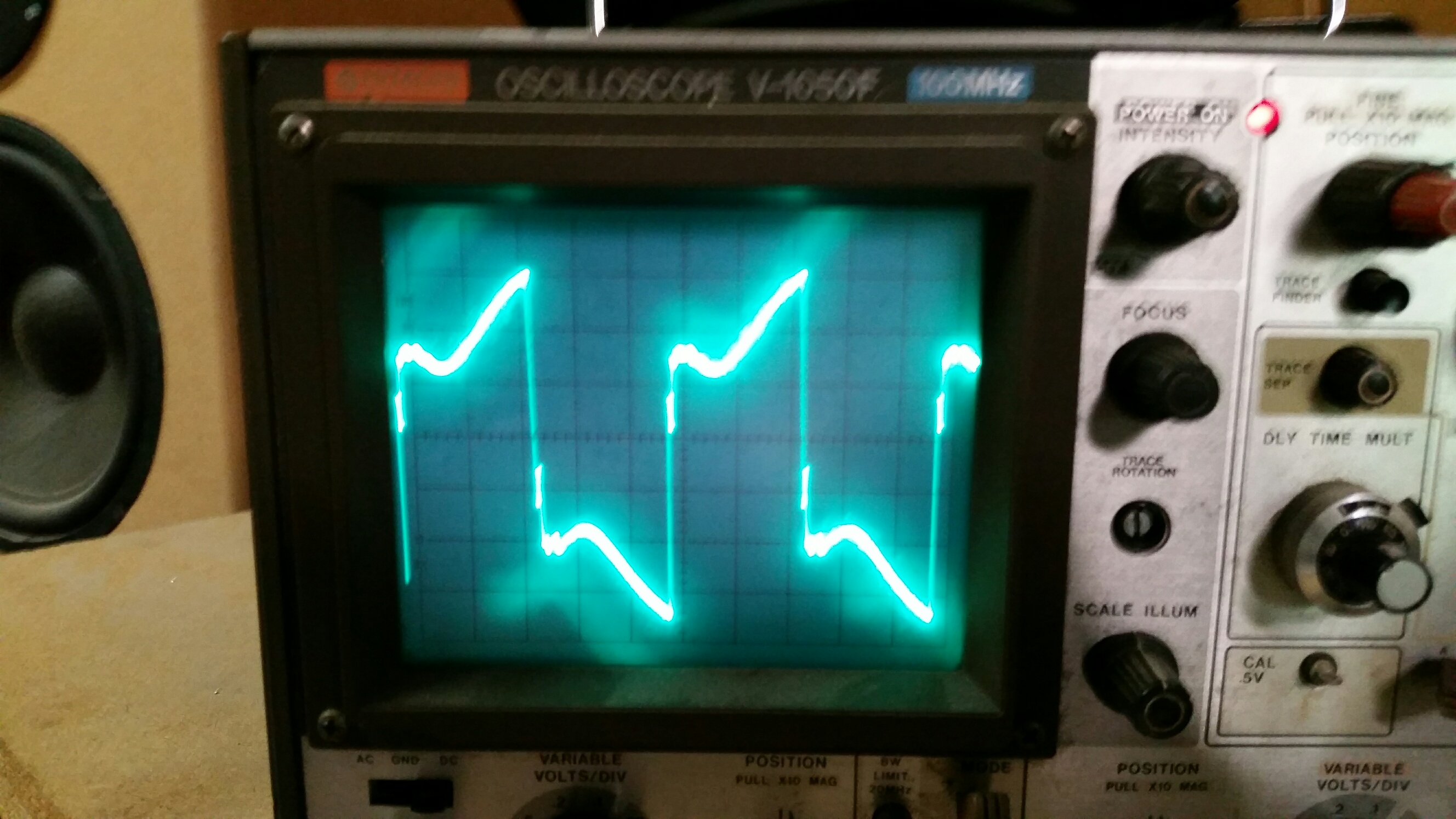

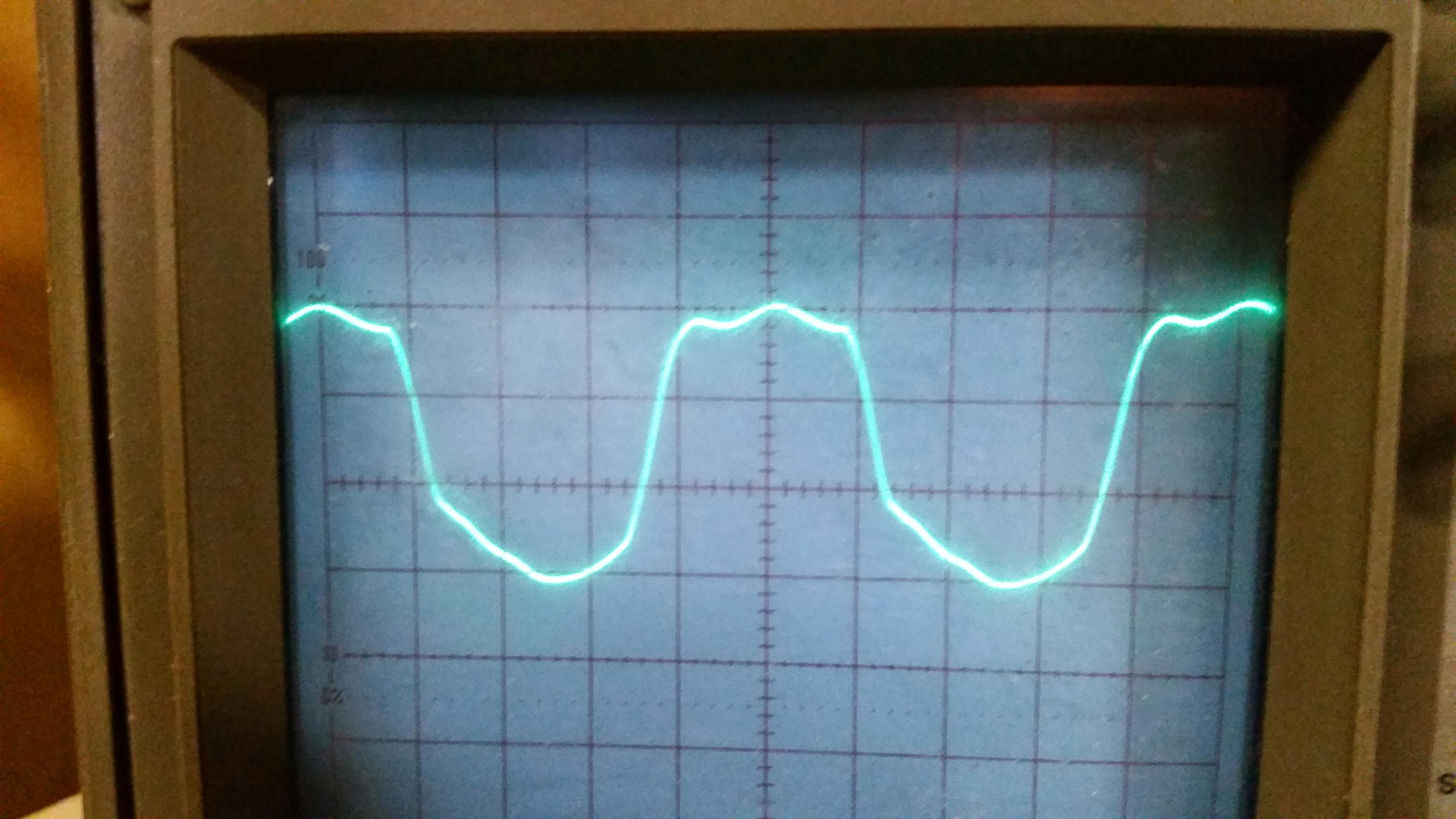

OK-- added a 1K CC directly to the pins of the KT88 (for a 2K gridstopper in series) and... no change.
Rearranged the wiring and... no change.
Removed the 50K pot and replaced it with a 10K and-- HUM IS GONE!!!
Also, my o'scope came back to life (after ordering another one, of course), so I was able to look at the square waves again. Per gingertube's suggestion I tested the waveform bot at AND before the outputs and found that there is ringing on the leading edge coming directly from the input transformer.
I tried loading the transformer with some 1uF caps I had and it made a mess of the waveforms. I'm not using any NFB, but could I still load the input transformers with resistance to straighten it out?
Thoughts?

OK, so it's been a while.
I've been working on finding the source of the shoutiness for some time now and I think I've resolved one major issue.
I noticed on my scope that the square wave became distorted when turning the 50K pot up and down, but not when I adjusted the source volume from my function generator. I replaced the 50K pot with an old Alpha 100K that I had laying around and the square wave stabilized.
The sound is much more focused and much less shouty now, however I think I am hearing some oscillation in the high frequencies, which may be coming from my phono preamp.
I'm still measuring and adjusting, but I'm getting closer. I'm working on an Aikido Tetra Sans phono pre as well, so hopefully that will resolve the source of the remaining high-frequency hash.
Talk soon.
Kofi
Talk soon.
Kofi
