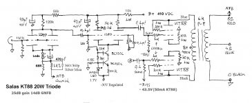

True, its more sensitive to apply extra, but when feasible its welcome.
This 20W amp took 14dB GNFB easily for example. I had it at 9dB initially but when I added +5dB extra feedback is sounded better. Did not get harsher, only cleaner. Note that I was using the 8 Ohm tap on 4 Ohm load so the reflected impedance was changed on the primary.

Generally the figure of merit for global NFB is considered to be around 20dB - somewhat arbitrary, but that is enough for a 10 fold reduction in both source impedance and distortion, it also means the multiplicative products are low enough that you no longer care too much about them.

Rongon-- BIG thanks to you for modeling it stem to stern. I know that must have taken a while! Thank you so much!
That is EXACTLY what was happening with my LTSpice model. I swapped the phase of the splitter and was able to twiddle away with NFB after that.
Not sure why, but I was able to get about 45W out before clipping on my model with 400mV in? I have to Boot Camp over to the Windows side (from the Mac / iOS side) to make the simulation work, so I'll post mine in a bit along with relevant THD.
Any concerns about the need to balance the current between each PPP pair? I believe the earlier advice was that it may not make much difference as long as I am able to get matched quads / octets or that a trimpot may be added to assist with balance.

No worries! I was curious to see what would happen, so it was fun. I'm seriously thinking of building a triode-wired version of this, to get maybe 8 to 10 W per channel. That would be enough for my needs. I have the iron and a chassis hanging around, so I should do it. But I have other unfinished projects in the way...
Your results will depend on the models you use for tubes and transformer. My OPT model is of a hypothetical OPT from a Dynaco Stereo 70, with measured coil resistances added from the real thing. They differed a bit from the model I downloaded, so my results may or may not more closely reflect reality than others'. I do know that a real-life Stereo 70 is capable of delivering about 20W max per channel, so when the sim gives 20Wpc I figure it's doin' it close to right. YMMV of course.
Paralleling spreads out the differences of individual tubes' current draw, so it should be possible to mix 'n match positions of the 8 EL84s to get reasonably good balance. With an EI or C cored OPT you can have a few milliamps of imbalance without much penalty. With a toroid core OPT it's more likely that you will have to be more careful about keeping current balanced between the primary windings. Beyond that things get complicated, and I'm not knowledgeable enough to go beyond that level of understanding. Maybe someone else would be willing to dive in here and clarify?

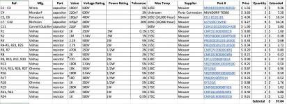

I am still working through the BOM for the power supply and such, but wanted to share my working copy now (attached as Excel file and picture). Please feel free to review and mock my choices as you see fit.

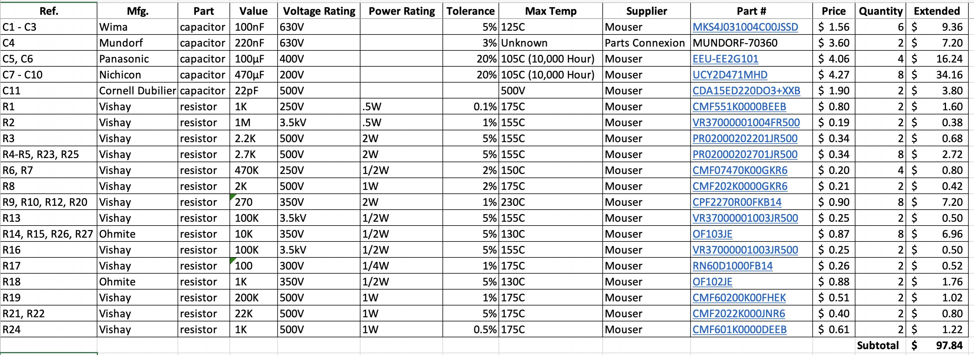

OK, so I'm moving forward and getting a parts list together, but it looks like I will need to ait eight weeks for Edcor to make OPTs. Hammond has an off-the-shelf job (the 1650RAP that's potted @5K primary / 100W. They also have the 1650N @4.3K / 60W.
Should I wait for the Edcors or press forward with the Hammonds to save some time? Is the quality of the Edcors worth the wait?
Kofi
Kofi

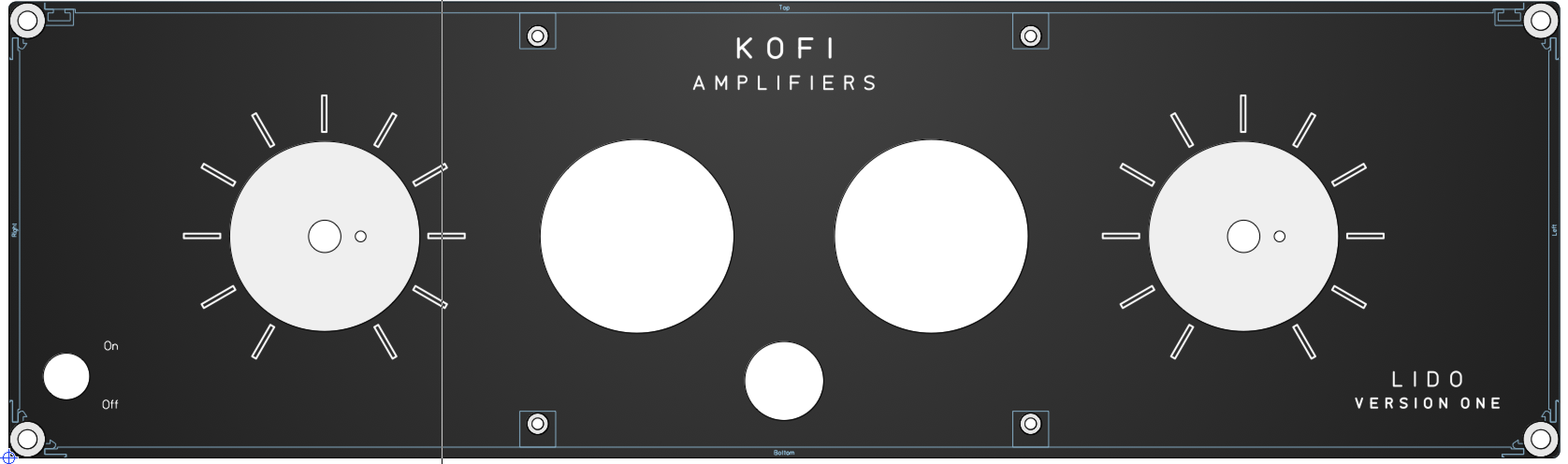

Oh-- and I need to add VU meters and was thinking about these. They don't need to be accurate-- just provide some pizzazz, so I'm hoping I can parallel them with the speaker outputs and throw a 3K6 in front of it to make that happen (i.e., would rather not have to make an op-amp buffer, if possible).
Any thoughts on that?
Kofi

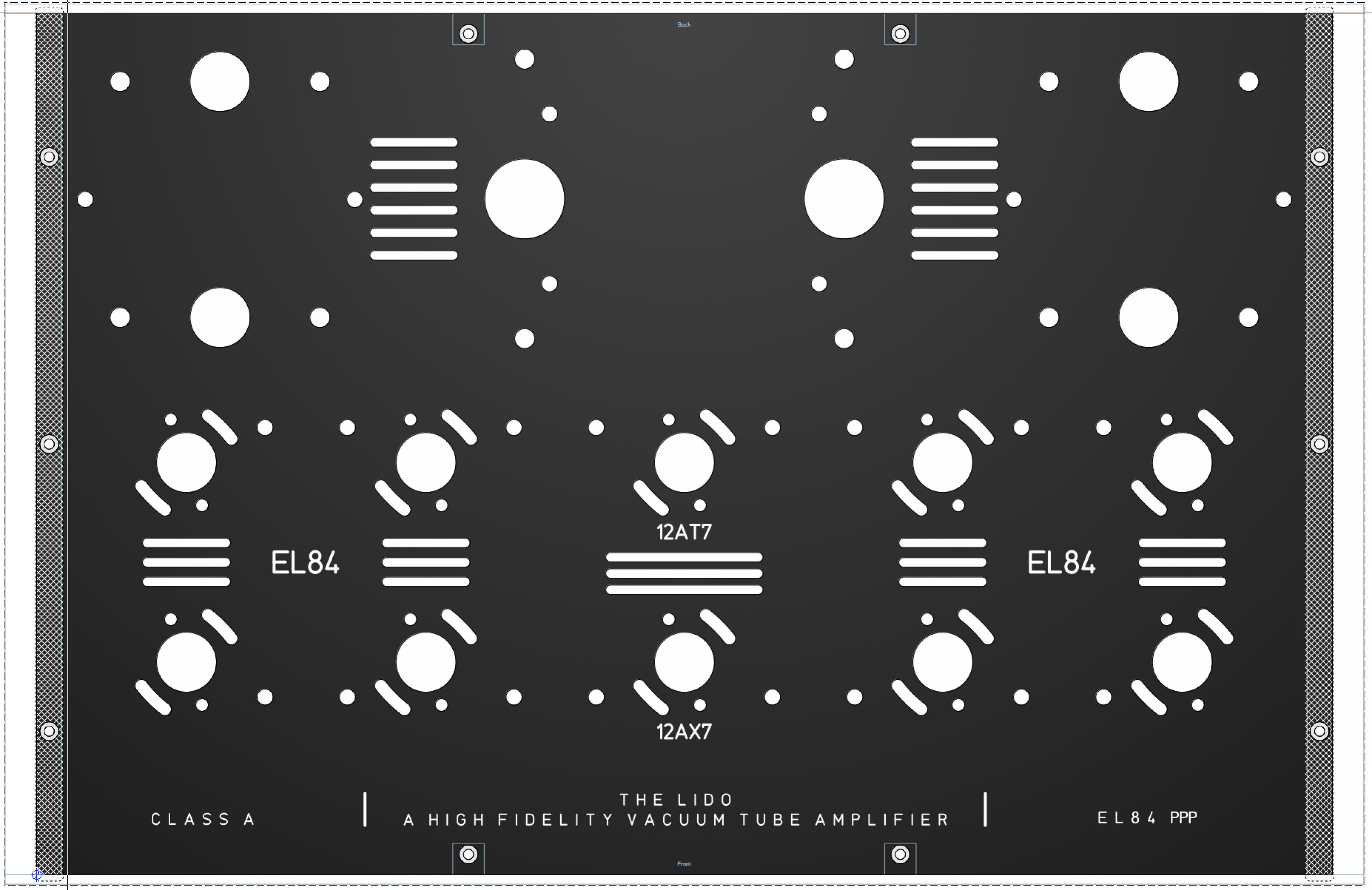

It's taken some time, but I believe I have a viable layout. Sharing in case anyone has any comments or edits. More to come soon.
Kofi

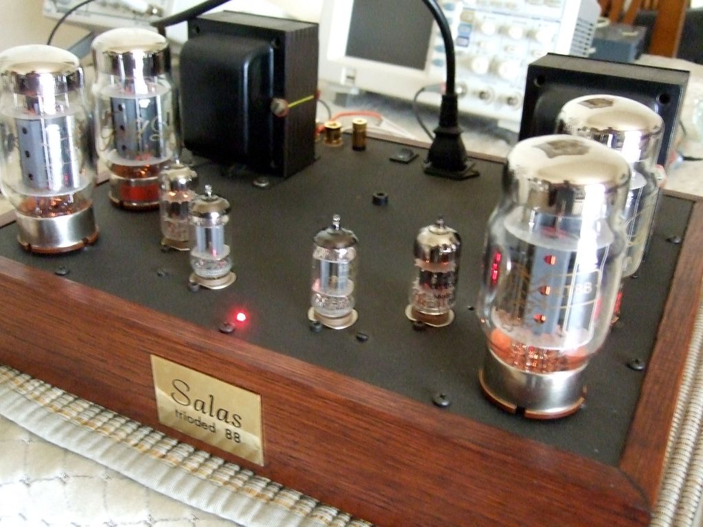

Looks good, I'd probably turn the 12AX7 and 12AT7 90° so that the phase splitter connections to each bank of output tubes are equidistant, this should help to make the HF behavior consistent on both channels.
I like the marketing pizzazz! 😀
...I'd probably turn the 12AX7 and 12AT7 90° so that the phase splitter connections to each bank of output tubes are equidistant, this should help to make the HF behavior consistent on both channels.
I had them placed that way originally, but I had to make room at the dead front for the VU meters, which required me to move the small guys back. Let me see what I can do to remedy that...
Gotta get the branding out there.
Kofi

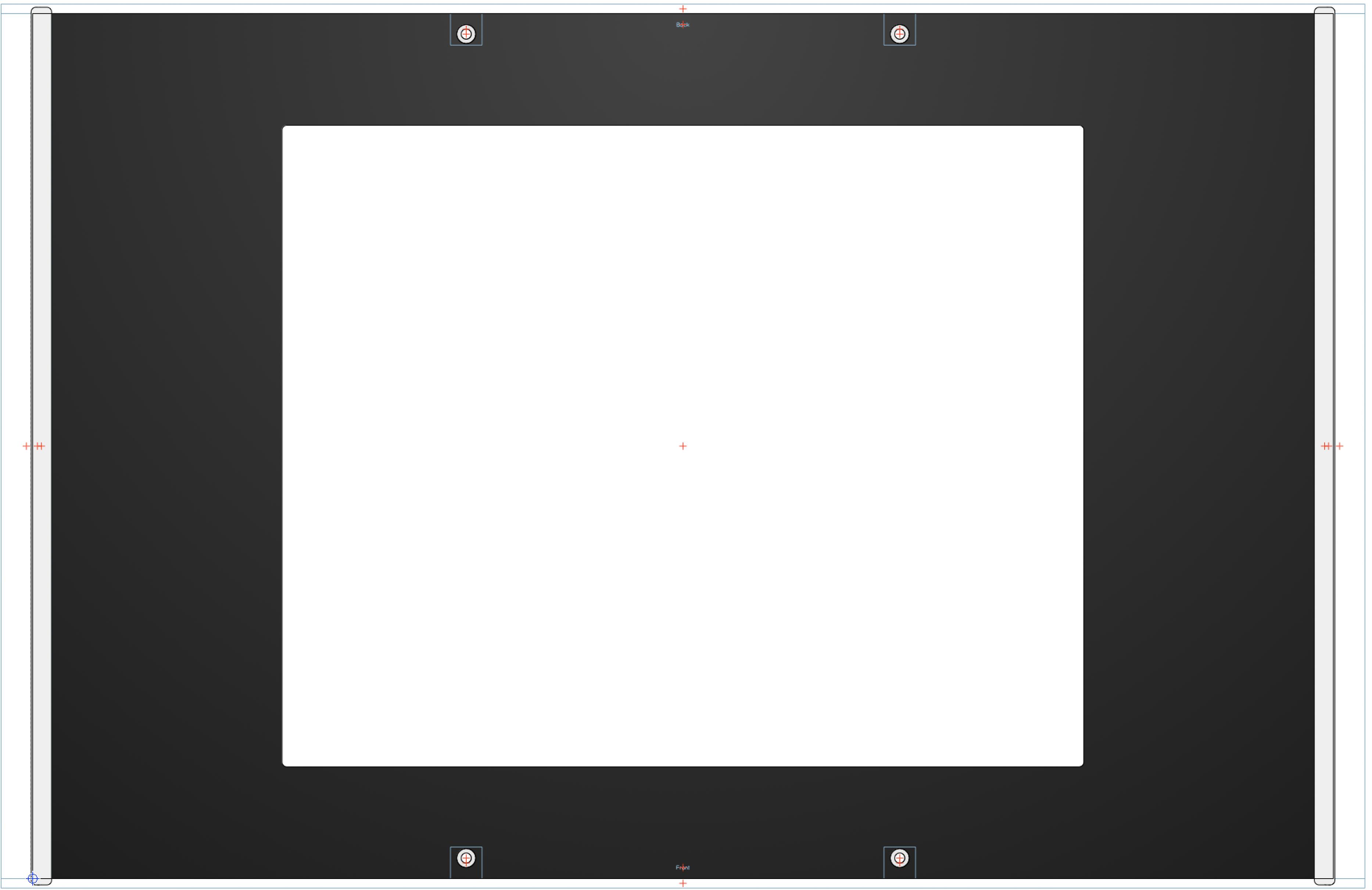

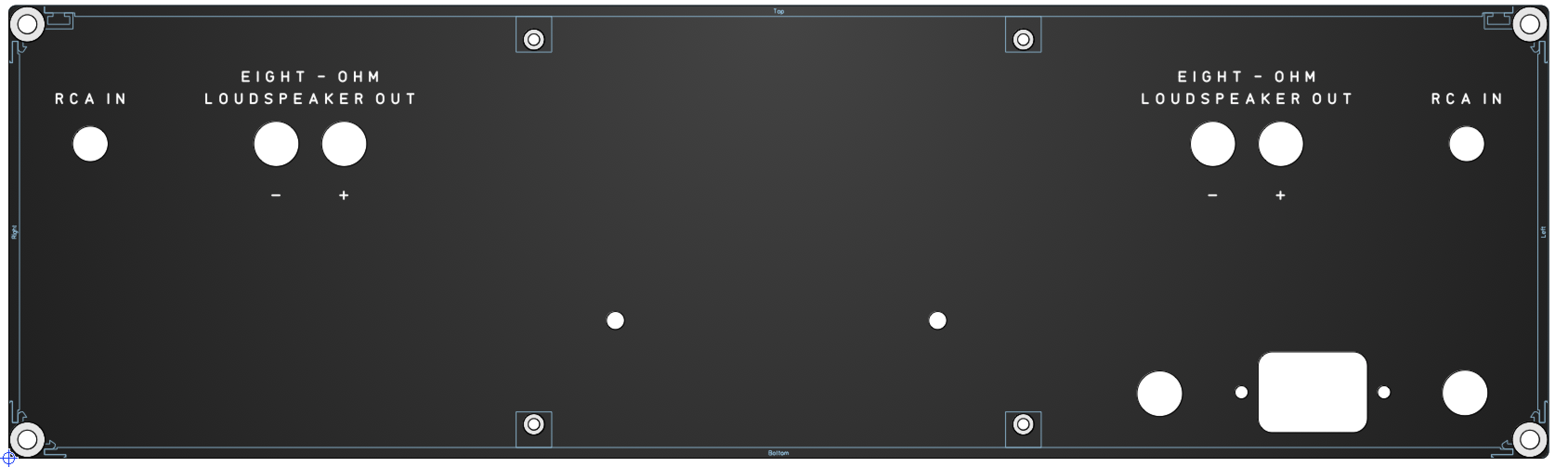

Anyway, wanted to share what I believe is the final layout of the panels. I got concerned about ventilation after reading Morgan Jones' aptly named (and wonderful) Building Valve Amplifiers. [SPOILER: It's about uilding-bay alve-vay plifiers-bay]. In it, he opines on how builders leave vent holes on top but close off the bottom of the amp when they should use perforated sheet metal to ensure air flow will move through the chassis. Well, I did ya one better MJ, cuz I made the bottom plate have a BIG HOLE. Nothing beats a BIG HOLE, amirite?
Of course, I'll safe-t-fy it with some inlaid hole-y sheet aluminum, but right now it's fun to see the BIG HOLE!
Take a look and let me know what you think. The two teeny holes in the back panel are for the choke-- could not fit it anywhere else and you know what Kofi just said about moverin' stuff, right?
Also-- need some help with the VU meters whenever someone can stomach it. I wound up going with these babies and I believe they have a 6-volt FESTOON lamp as illumination. I'm assuming these can run from AC and that I can power them from the heaters, but wanted to confirm. Also, hoping I can run these straight off the speaker outputs with little voltage dividering and can avoid making a two-channel buffer amp to serve up the signal to the meters.
Anyone? ANYONE?
Kofi?
Hole in The bottom is BAD idea. Any opening large enough to put your hand through is a horrible idea. Someones 5 year old will find it. Or some idiot will try to pick it up and grab a hot capacitor. Please make it lots of smaller holes! The inlaid alu sheet could work loose or worse. Plus it will affect the structrual integrity of the chassis...
