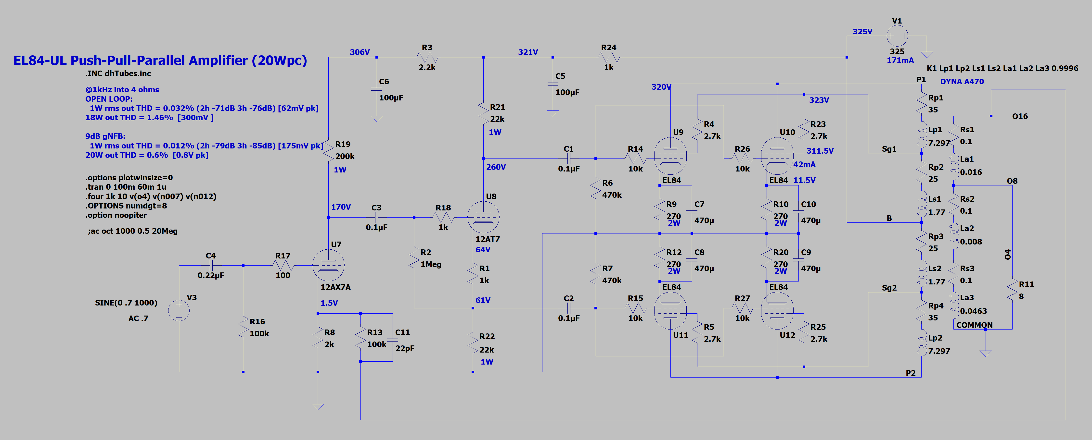

Here's the final design. Note that the voltage is 325 in the schematic, not 300. Reducing the voltage will negligibly increase distortion and reduce output current, but would pull the EL84s back in line with max operating voltage and power dissipation.
For the record, I'll be using some NOS Russian mil spec equivalents (matched octal) that should be rugged enough for the task, however it's possible that the client changes does some tube rolling in the future with less durable models and winds up red plating.
I do currently run a Baby Huey EL84PP with about 320 on the plates, but since this will wind up with a client, I think it would be wise to ratchet it back a bit.

That's going to be a nice amp. That's a great selection for the OT. If I was going to keep it I'd leave it like it is power supply wise. I mean it's right on the edge after taking into account the cathode voltage. But as you say, you can't tell what the client may do. I'd definitely not make any changes to the power supply until you have it powered up and see where you actually are.
Thanks! You should know that the design was a team effort (kevinkr, Lingwendil, rongon and others with rongon working up the final design in LTSpice).

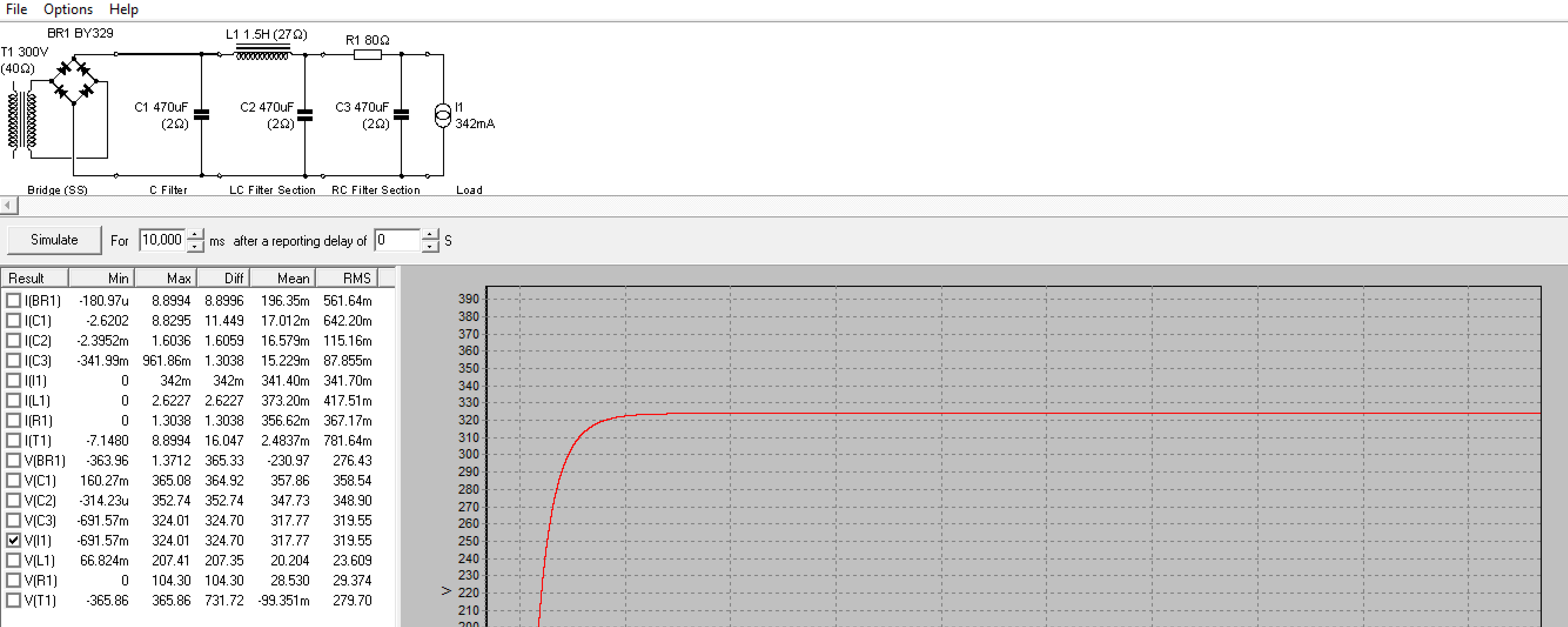

I have attached the PSU design. Note the 80R resistor was in series with the circuit but without the final cap. And it smoked at around 50VDC.

With 60VDC across a 400R resistor, it is dissipating 9W, so yes, it will get very hot and I believe de-rate quickly from there. 65VDC and you are over the limit of 10W.
I modeled your same power supply in PSUD2 and got the same exact results, of course. I'm kind of at a loss.
